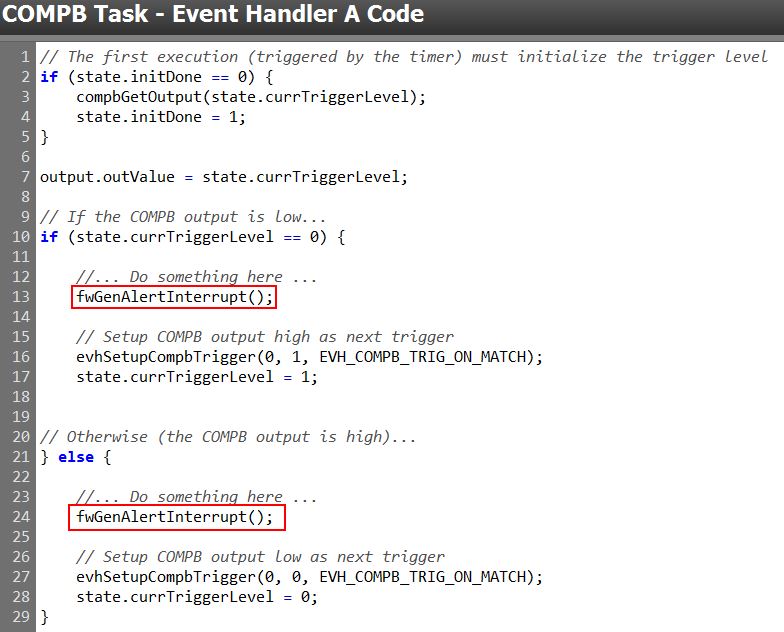

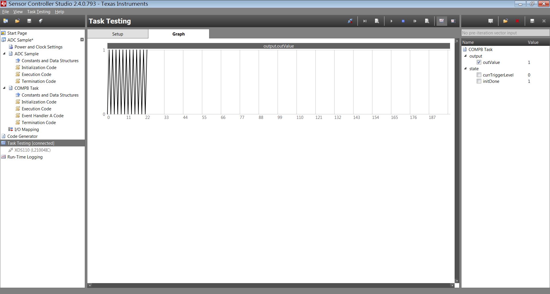

I try to add compb task in sensor controller. but not working.
I want to alert M4 when the input voltages on DIO27 larger than about 2.6v.
I expect there is a message output from uart but fail...(NodeTask.c Line:247)
Please help to check if anything I miss within the code.
