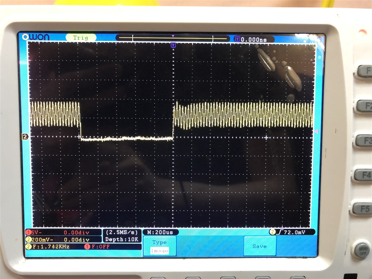

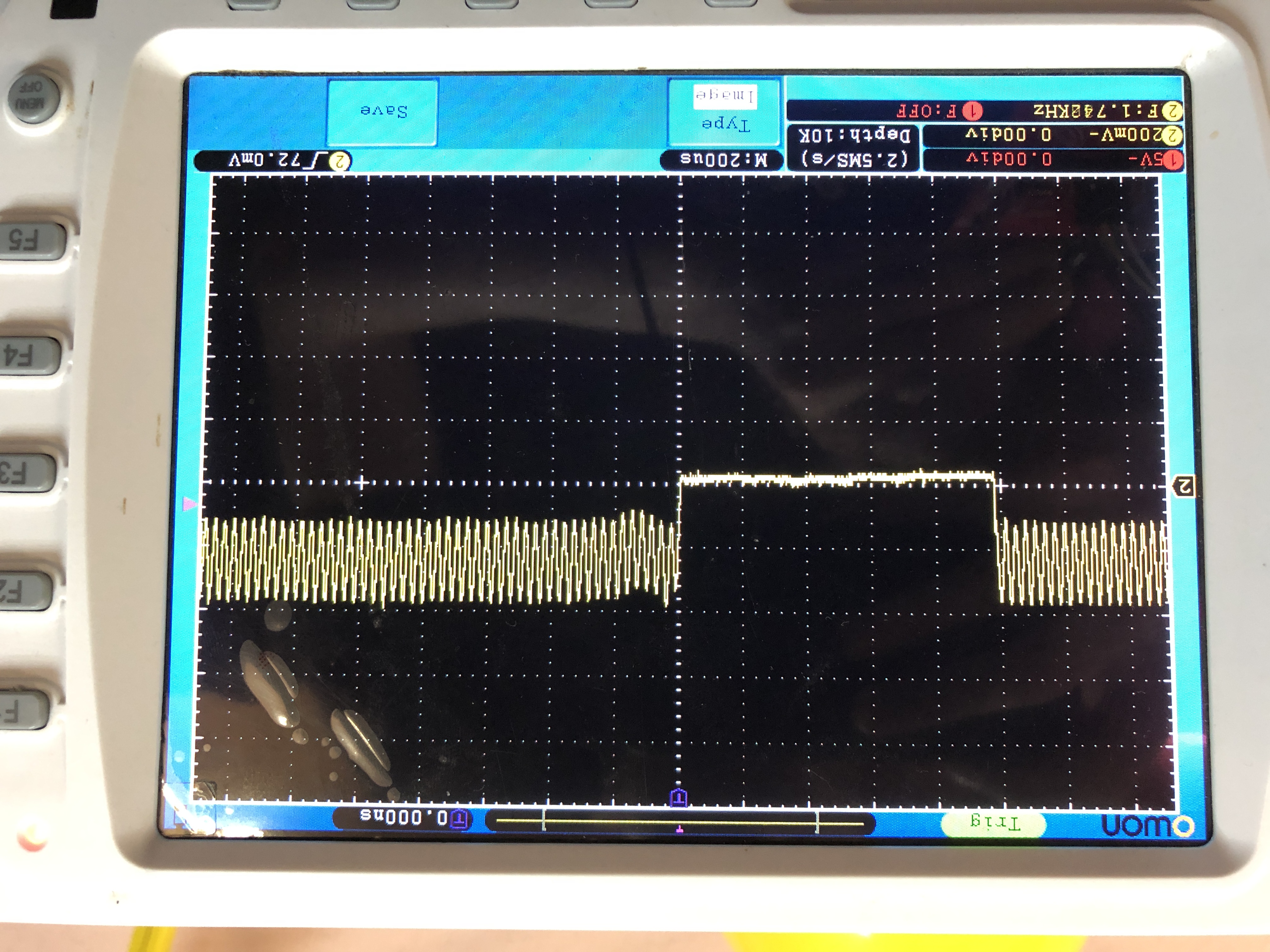

  • Back to my problem. Below I attached a picture. It shows the sine wave from crystal at 32 kHz. An empty gap (hole, pit, and so on) appears as soon as I try to call the Task_sleep () function. If in the code written above (in the previous message) to comment out the call to this function, then the sine wave goes without interruption. Apparently, due to this gap, the chip cannot go to sleep and therefore I see a strange program execution (the IOID_9 leg does not switch every 5 seconds). This behavior occurs when using an internal LF crystal (LF RCOSC), and when using an external (LF XOSC). I replace the crystal in the ccfg.h file (#ifndef SET_CCFG_MODE_CONF_SCLK_LF_OPTION)
  • If you have selected the internal RCOSC as LF clock you should not have a signal on the XOSC pins in the first place.
    I suspect that it's something wrong with your hardware but I'm not able to see what it is based in the information given.
