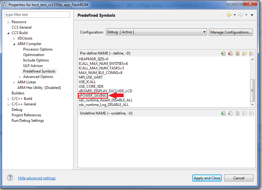

Hi everyone! I'm working with the cc1350 launchpad in order to perform an Off-chip OAD. My setup consists of two cc1350 launchpads and a pc. I'm using Code Composer Studio.
I'm following the Out of the box Demo (Off-chip OAD) - dev.ti.com/.../oad.html
but, first of all, the tutorial send me to the BTool setup here http://dev.ti.com/tirex/content/simplelink_cc13x0_sdk_2_40_00_20/docs/blestack/software-developers-guide/ble-stack-2.x-guide/oad/oad.html#btool-setup
My first problem is in Btool setup when I have to disable POWER_SAVING from my host_test application. In the Predefined symbols of my host_test app I find xPOWER_SAVING. Is it the same? I can delete it?
If I delete xPOWER_SAVING a build error occurs in CCS.

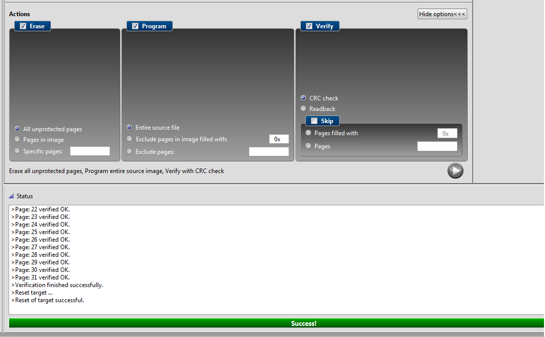

By using SmartRF Flash Programmer 2, I connect my cc1350 launchpad host and I program it with the hexfile using the options below
All of this is performing in ONE of the cc1350 launchpad. Now move on to the other.

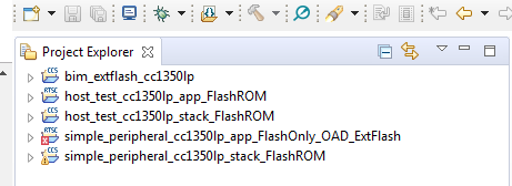

Then, I return back to Out of the box Demo (Off-chip OAD) and so, returning to CCS, I build and load bim_extflash_cc150lp to the other board (not the board in which I've uploaded the host), I build and load the simple_peripheral_cc1350lp_stack_FlashROM project to the same board, and finally I build and load the simple_peripheral_cc1350lp_app_FlashOnly_OAD_ExtFlash. This is my Project Explorer:
After loading simple_peripheral_cc1350lp_app_FlashOnly_OAD_ExtFlash project, the subsequent errors occur:
Do you have any idea why I have a memory problem with a default example for the launchpad? How can I resolve it?

  • 1. I undestand that the Predefined Symbol xPOWER_SAVING means that POWER_SAVING is disabled. So in my project POWER_SAVING is desabled by default.
    2. Concerning cc1350lp_host_test.hex hexfile, maybe I need to upload to my host launchpad the hexfiles generated from builded project (so debug folder from each project). I means:
    host_test_cc1350lp_stack_FlashROM.hex
    C:\Users\Student\workspace_v8\host_test_cc1350lp_stack_FlashROM\Debug
    host_test_cc1350lp_app_FlashROM.hex
    C:\Users\Student\workspace_v8\host_test_cc1350lp_app_FlashROM\Debug
    First the stack and after the app.
    3. I've fixed my problem with the memory, but now, following the Out of the box Demo, I'm not able to connect my device to Btool. Which is the device I need to connect to BTool? The host device or the simple_peripheral device?
