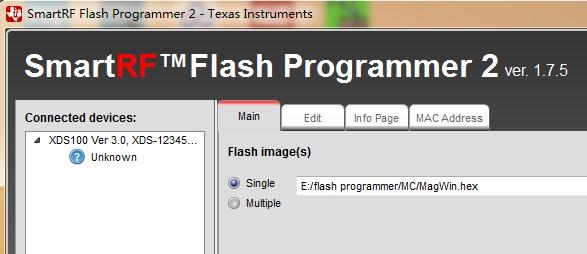

We are now meeting a strange problem for flash CC1310 in our sub-G application.
The software we use is FLASH-PROGRAMMER-2.
When we first burn the flash of CC1310, we could not burn it again. And we can verify that the programming burned into CC1310 is running normally.
We see that CC1310 could not be recognized again from above picture.

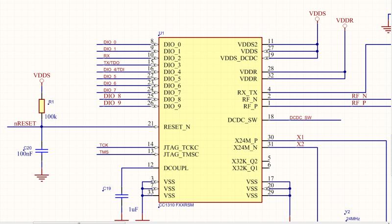

And we realized that this may be caused by our wrongly configuration of CC1310 pins. Then we modified our code and the new CC1310 can be burned repeatly with the new code.
My question is:
Do you have some way to reburn the CC1310 with old code already flashed into it?
