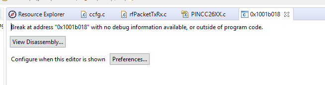

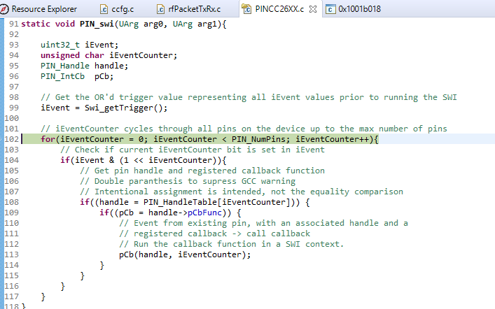

  • I tried to debug it step by step. The code goes in this loop under PINCC26xx.c and then gives error as below.
