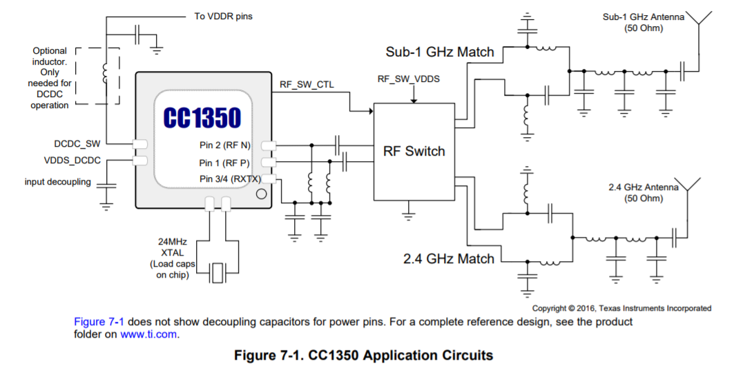

Dear all
As below picture, does the CC1350 device support Sub-1GHz and BLE together ? Like when sub-1Ghz and BLE signal coming, the CC1350 could get the two signal .
  • Do you need to support full BLE capability such as BLE peripheral? If so, CC1350 doesn't have enough RAM/Flash for supporting Sub-1GHz and BLE together. I would suggest you to use CC1352R instead of CC1350.
