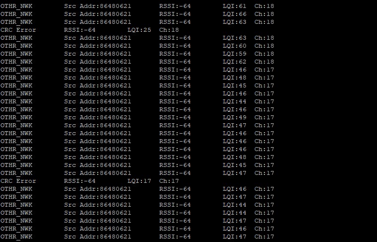

During our product development we are facing a weird issue CC1200(863 MHz to 870 MHz) is unable to send on Channels number greater than 27 but Reception is working fine. Why this strange issue.

  • [1] we are using 866 MHz band with starting channel 0 = 863 MHz base frequency
    [2] We are using CC1101 as Tx device and CC1200 as Rx, but when we make CC1200 as Tx our CC1101 is not able to receive on Channels greater than 27
    [3] Yes we have spectrum analyzer and it shows some activity on channels greater than 27 but CC1101 Rx is not able to receive somehow. Channels 0 to 26 works fine both as Tx and Rx on every CC1101 & CC1200
    [4] We are using the same firmware for channels 0 to 26 and for channels 27 to 56
  • ...and how wide is the channel?
    I assume that you do exactly the same when you try to use channel 0 as channel 56? It should be no difference in how the chip behave @863 MHz and @870 MHz.
    Are you able to use SmartRF Studio to control the CC1200 board via a CCdebugger?

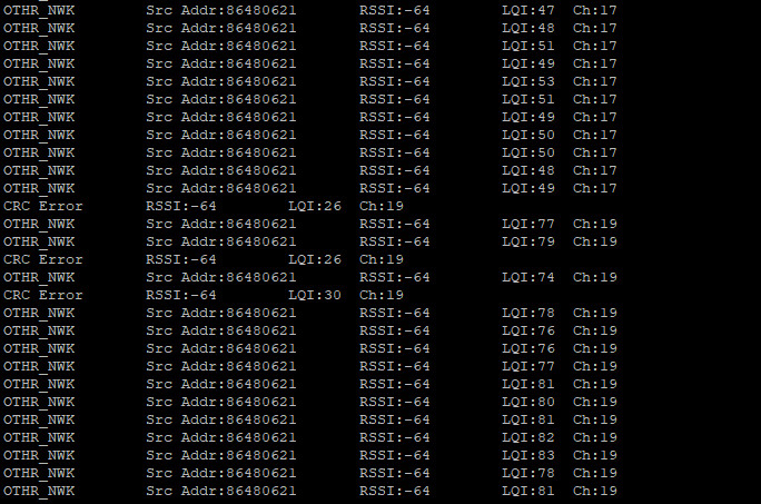

    We have observed that with the increase of channel number like 10 or above the LQI value start increasing from 42 , and finally at channel 27(LQI is 127) or above the CC1101 RX is enable to receive any signal from CC1200 TX

  • [1] Same Rx BW is being used on CC1101 side also and no issue on it. For CC1200 PPM crystal is 40 MHz default
    [2] I haven't manually set Freq Reg. But I will try it manually
    [3] Spectrum Analyzer shows activity on all channels we are using 0 to 56. But as in my previous reply. We observed that our RSSI is valid but with increasing channel number LQI increases to a point 127 value. where CC1101 Rx is unable to receive.
    [4] We are using CC1200 with 915 MHz and up till now no issue is observed on it.
    [5] Screen shots are also attached.
    Normal communication at channel 17 (CC1101 Rx) Side
    Issue Started Channel (19) (CC1101 Rx) Side

  • Dear All,
                  we solved the issue by changing the Rx Filter bandwidth and Deviation as per our project.
                   Rx filter bandwidth for our scenario was changed 104 kHz to 205 KHz
                   Deviation for our scenario was changed 10 KHz to 24 KHz
    and everything started working properly b/w CC1100 & CC1200 and vice versa.
