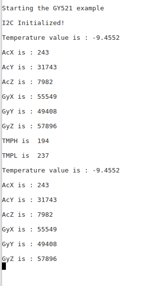

    Hi Simon J,
    Thanks for correcting.
    After those changes, it's reading some garbage values from the sensor register.

        txBuffer[0] = 0x3B;
        //txBuffer[1] =0x6B;
        i2cTransaction.slaveAddress = 0x68;
        i2cTransaction.writeBuf = txBuffer;
        i2cTransaction.writeCount = 0;
        i2cTransaction.readBuf = rxBuffer;
        i2cTransaction.readCount = 8;
        status = I2C_transfer(i2c, &i2cTransaction);

        for (sample = 0; sample < 30; sample++) {
            if (I2C_transfer(i2c, &i2cTransaction)) {
                /* Extract degrees C from the received data; see TMP116 datasheet */
                //temperature = (rxBuffer[0] << 8) | (rxBuffer[1]);
                //temperature *= 0.0078125;
                AcX =   (rxBuffer[0]  <<8) | (rxBuffer[1]);
                AcY =   (rxBuffer[2]  <<8) | (rxBuffer[3]);
                AcZ =   (rxBuffer[4]  <<8) | (rxBuffer[5]);
                TMP =   (rxBuffer[6]  <<8) | (rxBuffer[7]);
    //            GyX =   (rxBuffer[8]  <<8) | (rxBuffer[9]);
    //            GyY =   (rxBuffer[10] <<8) | (rxBuffer[11]);
    //            GyZ =   (rxBuffer[12] <<8) | (rxBuffer[13]);
                //TMP *= 0.0078125;
                Temperature =TMP/340.00+36.53;
                Display_printf(display, 0, 0, "Temperature value is : %f \n",Temperature);
                Display_printf(display, 0, 0, "AcX is : %d \n",AcX);

  • #include <stdint.h>

    And it returns this :
    Still no luck.
    -Lakshminarayana K N
  • txBuffer[1] = 0x3B; should be txBuffer[0] = 0x3B; otherwise you will start reading from whatever is stored in txBuffer[0].
    -Simon
  • With those changes as txBuffer[0] = 0x3B;
    I'm able to read constant Temperature of(35C) and even the accelerometer values varies when sensor moved.
    but Gyro values returning zero.
    -Lakshminarayana K N.
