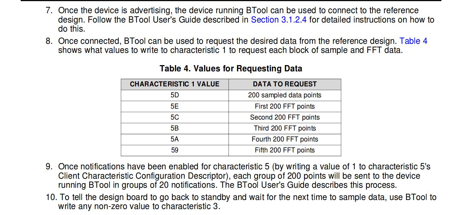

  • Mily,
    Can you elaborate on the steps that you did to collect the data?  Did you do something similar to the below sequence?
    • Flash TIDA-01469 onto CC1350 Launchpad
    • Setup another CC1350 to use with BTool
    • Run TIDA-01469 firmware
    • Use BTool
      • Connect to TIDA-01469
      • Write 1 to characteristic 5 to enable notification
      • Write 0x5E to characteristic 1 to read first 200 FFT points
      • You should now receive 20 notifications
      • Write 0x5C to characteristic 1 to read second 200 FFT points
      • etc...

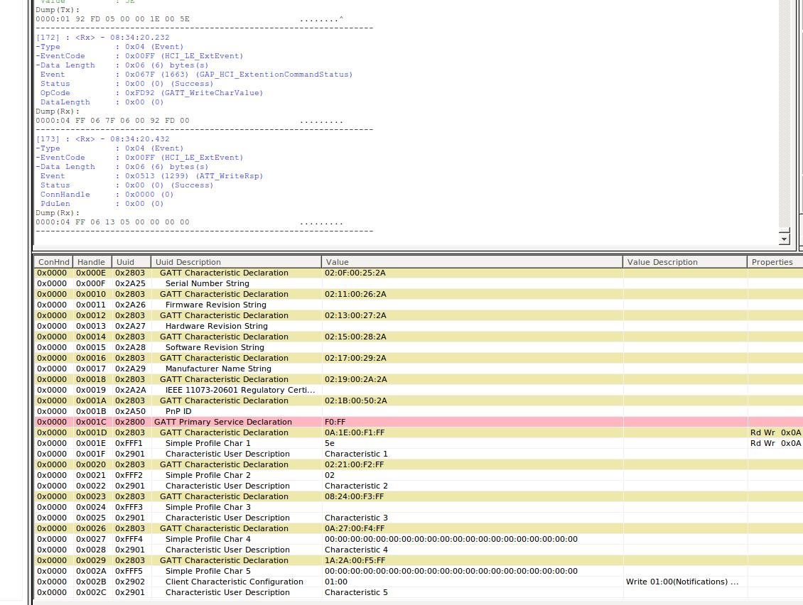

    Below are steps followed by me:
    1. I have loaded the CC1350 launch pad with Simplelink app available in TIDA firmware 1.0 folder and simplelink stack available in ble sdk 2.02.01.18 folder.
    2. To power up the module from battery, I removed all P4 jumpers(XDS power jumpers and JTAG signals) and P10 jumper on CC1350 board as described in section 3.1.1.1 in data sheet.
    3. Connected TIDA-01469 sensor board to the CC1350 board and connected J3 jumper to power up the module.
    4. Now I have connected another module to PC, with host test application running in the module and BTool app running on PC.
    5. Established connection to TIDA module from BTool.
    6. Wrote 01:00 to Client characteristic configuration descriptor 5.(It's accepting 01:00 or 02:00)
    7. Wrote 5D (Tried with 59, 5A, 5B, 5C, 5E)to the Simple profile char 1.
    You can the values of Char 1 and Char 5 in attached screen shot.
    But I am not receiving any notifications, can you tell me what are the changes I need to do. If you have already pre build hex binaries please share, I will try with them.
    Mily.

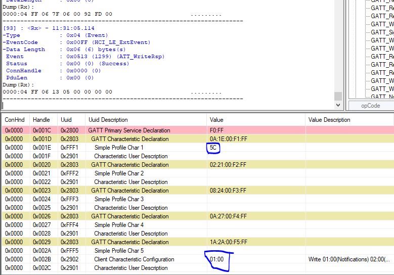

  • Dear Christina,
    Can you suggest me what are the changes that I need to do in simple link app for enabling notifications? I am unable to identify the issue, when I debug the code data is written to character 5 descriptors, but data is not coming to BTool. Can you suggest me what are the changes required in app. Is there any code versions available for app?
    Is there any optimization settings need to be modified? Current optimizations settings are at level 4.
    Mily.

  • No, That is where I stuck. I am trying to receive notifications without any modifications in the code.
    1. Clam when I debugged the code data(non zero values) is written to character 5 but when I read character 5 it's all zero' only, why data is not reflected?
