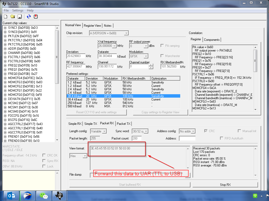

I have purchased a CC1110 module and i have connected it to my computer using cc debugger and using smartRF studio to configure this module and also to see the packets from my target RF device.
Now I want to connect TTL to USB converter to the CC1110 module for receiving RF packets from my target device. I have connected TTL to USB converter on pin P0_3 & P0_2.
Can you guys please advice me on how to achieve this?
    Please see examples in the software section of this link for serial port. www.ti.com/.../toolssoftware
    Can you give more information about the radio setup on the target device? You should be able to receive packets on SmartRF stuido if you configure the CC1110 radio properly(i.e. with same modulation and RF parameters as the target RF device).
  • Yes, i was able to see the packets from my target device in the smartRF studio. I just want output the data which I see on the smartRF studio as UART. I have attached the image which shows the data rrom the target device.
    Looks like you are using a very old SmartRF stuido version.
    Anyhow, you will not be able to output this received data to UART from SmartRF Studio.
    You should modify the receiver example in the code(link above) to get the packet and then output it to console.

    Please see the basic radio code posted here:
    e2e.ti.com/.../1196004
    This link will be helpful as well :
    e2e.ti.com/.../341608
    To configure the radio parameters use the latest SmartRF stuido to export(copy/paste) the parameters into the code.
    After going through the links you provided and using 3513.CC1110 code, have copied the parameters from the SmartRF studio into this code but after compiling and deploying the hex file to the module I don't see any data coming to UART 0 which is connected to TTL to USB converter.
    Below is the code:
      Filename:     comlab_09_19_11_868_smartrfcc1110.c

      FREQ2 = 0x10;
      FREQ1 = 0x76;
      FREQ0 = 0x27;
      FSCTRL1 = 0x06;
      FSCTRL0 = 0x00;
      MDMCFG4 = 0xCA;
      MDMCFG3 = 0x83;
      MDMCFG2 = 0x13;
      MDMCFG1 = 0x22;
      MDMCFG0 = 0xF8;
      CHANNR = 0x00;
      DEVIATN = 0x35;
      FREND0 = 0x10;
      FREND1 = 0x56;
      MCSM0 = 0x18;
      FOCCFG = 0x16;
      BSCFG = 0x6C;
      AGCCTRL2 = 0x43;
      AGCCTRL1 = 0x40;
      AGCCTRL0 = 0x91;
      FSCAL3 = 0xE9;
      FSCAL2 = 0x2A;
      FSCAL1 = 0x00;
      FSCAL0 = 0x1F;
      TEST2 = 0x81;

    Download the basic software examples from here:
    Then use the UART example and add that code to the radio code supplied in earlier links.
