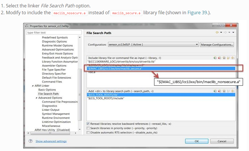

I studied Ti simplelink CC13x2 TI 15.4 - stack user's guide. Document mention that, To build the image with no security, perform the steps that follow:
In application maclib_secure_combo_cc1352.a file is there.
maclib_secure.a and maclib_secure_combo_cc1352.a, these two files are same or not ??

Also yes those 2 libraries are equivalent, the names have changed in some releases of the SDK

The fastest and easiest way of enabling/disabling security is by going to the file config.h and set "CONFIG_SECURE" to true if you want security and false if you want to remove security.
If you are using security, TI 15.4 Stack uses AES 128 for encryption and a 32 bit MIC(Message Integrity Code) by default. The default security key is defined by KEY_TABLE_DEFAULT_KEY in config.h
