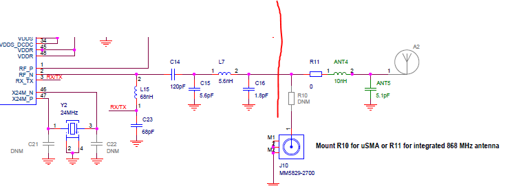

I'm trying to link a cc1310 to a very well-tuned antenna without using a balun. I directly link RFN to the antenna and leave floating RFP as well as TXRX.
My settings code is the following. I have frontendMode = 2 and biasMode = 0. The performance is very bad. Is there something else I should be aware of? The antenna is extremely good and I have both cc1310 and the same antenna running the same code on both sides. performance is OK but not outstanding. The Excel Range Estimator says that I should get 100s meters.
(Note that the antenna has a direct connection to ground so I have also tested with a 100pF capacitor between RFN and the antenna).
Also, is it better not to use the internal bias? Then how to calculated the inductor value?

  • See 2.3 in www.ti.com/.../swra640a.pdf
    The optimal load for a single ended output is not 50 ohm and hence you get poor performance. You still need matching when you want to use a single ended solution.
  • This is interesting but I'm a little bit confused:
    - first on page 7 of swra640a.pdf, I think that there is a mistake in the title of figure 1. Red is not required if *internal* bias is used (not external). Or is it?
    - secondly, on the CC1350STKEU_Schematics (1.5.0), if I use the internal bias, I don't have to install L15, C23. Correct?
    - thirdly, C14, C15, C16, L7 are fixed values to optimize the load of RF_N (both in emission and reception) to a 50-ohm antenna. Correct?
  • - This is a typo, I have asked that it should be changed a couple of times... You are right, it should be internal in the text and not external.
    - That is correct
    - Yes
    Any reason why you want to go single ended vs using a IPC if you are space constrained?
  • Right now, I have seen better range performance with single-ended despite zero matching rather than differential + IPC. Same software in both cases except the two settings mentioned at the top of this question.
    I have lost confidence in the IPC (see my other question) despite a correct routing of the IPC. It should give better performance but it doesn't. It might try Murata instead of Johanson but I'm not expecting something different.
  • Ok, I suspect something strange with your IPC usage since you get very poor performance but we take that in the other thread on the topic.
  • Still on this thread, how do you tune those passive components between the single-ended chip and the antenna? I know how to tune an antenna but I'm not sure how to do this in this case.
  • Not sure what you mean.
    The schematic from the CC1350STK:
    The components to the left for the red line is fixed and you don't need to change them (given that you operate in the 868 MHz/ 915 MHz band). The components to the right of the red line are the components that can be used for antenna tuning. Could you describe in more detail why you are not sure how to tune the antenna in this case?
  • I wanted to know from where those values were coming and how they were calculated (if I can reproduce in my lab). Are there the same for 868 and 915  (you seemed to say yes) but there are two schematics in swrc321a.zip marked US and EU and the US schematics has 868 (confusing)... There is another thread on E2E that gives completely different values for 400MHz so I was thinking that those values would have to be tuned per PCB/layout/frequency like for an antenna... You are implying the opposite (which is fine).
  • The reason for the US/ EU marking is that the antenna on the STK has a bandwidth that only covers one band. Hence the components to the left of the red line are the same for both EU/ US but the antenna matching components are different.
    The matching network is also frequency dependent but one set of values covers both 868 MHz and 915 MHz/ give good performance for both bands. If you need a frequency outside these bands you also need to change the matching components.
