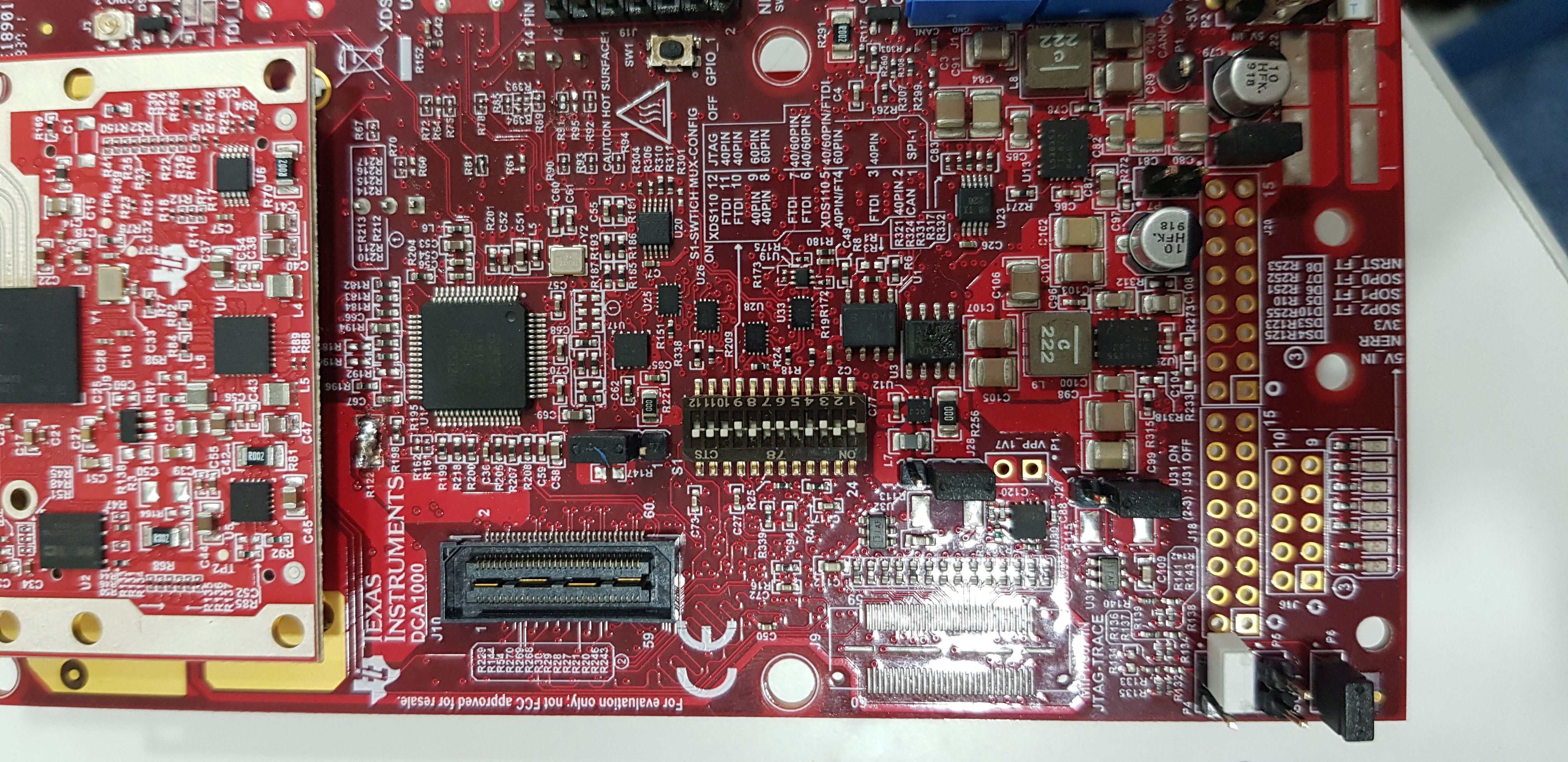

    Please check the modification in the attached picture.

    It's a little difficult to tell from the picture, but the hw modifications look ok.
