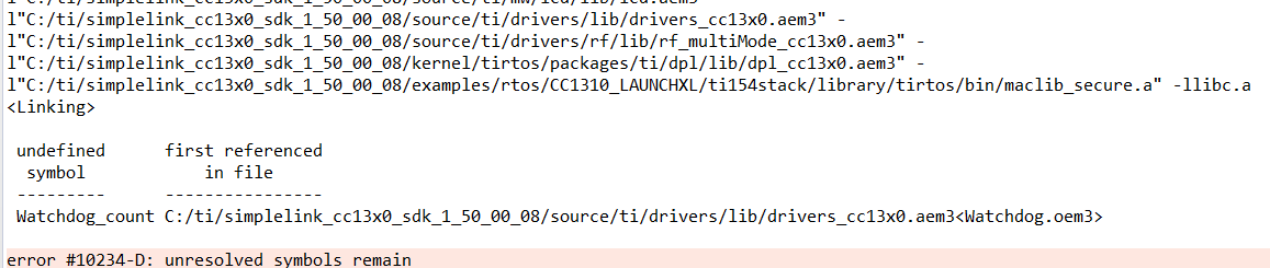

I am trying to make software watchdog to check if all tasks are going on or halted for long, I got a hint from https://e2e.ti.com/support/wireless-connectivity/sub-1-ghz/f/156/p/529212/2081970#2081970 this reply.
I am using sdk cc1310 - 1.50. Since then watchdog library is changed somewhat eg. .intNum = INT_WDT_IRQ, field is removed from WatchdogCC26XX_HWAttrs . On compiling i am getting a linking error.
Below is the code i am using for watchdog thread. What's gone wrong?

    First of all, you are using quite an old SDK version; it could be a good idea to update it.
    Secondly, are you writing all your code in the same file? I mean normally a part of the code such as watchdog_objects, watchdog_hwAttributes, Watchdog_config is supposed to be in what we call “board files” (Board.h, CC1310_LAUNCHXL.h and CC1310_LAUNCHXL.c). If your project is just made for some small tests, it should not be a problem, however if you are planning to develop a bigger project you should pay attention to this point.
    Regarding the error you are experiencing: the linker cannot find one of the symbols he needs. The Watchdog driver relies on the variable Watchdog_count but this variable has not been declared. If you simply declare somewhere the missing variable, it should be fine (you can add this declaration: const uint_least8_t Watchdog_count = 1). Please note that normally this declaration is made in CC1310_LAUNCHXL.c
