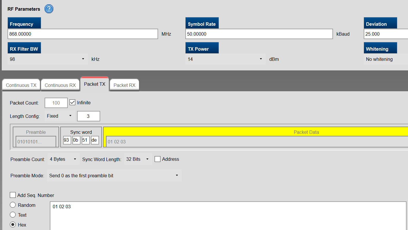

My customer use below packet format as Tx on signal generator in order to measure sensitivity, but don't know how to calculate 2 byte CRC.
AA AA AA AA AA 2D D4 40 [55 ...55] CRC
5 Byte AA as preamble.
Sync word is 2D D4
Packet Length is 40(64Byte)
Payload is 64 byte 55
2 Byte CRC
    A way would be to use the same packet setup as above and transmit it using a launchpad.
    Then on the receiver launchpad use fixed length to receive the entire packet. The last 2 bytes are the CRC.
    Then use that CRC value in the signal generator.
    Otherwise you can use the CRC polynomial to calculate the CRC.
    See here: e2e.ti.com/.../520740

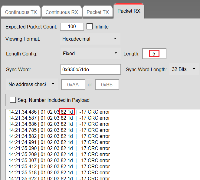

  • Daniel, if you want to see the CRC of the received packet is you have different options.
    - You can use append status
    - You can use fixed packet length in SmartRF Studio on the receive side and set the length a few bytes too long, the CRC will then come as part of the payload.

    1. How to see the append status?
    2. I have used the 2nd method to see CRC by extend receive length but failed.

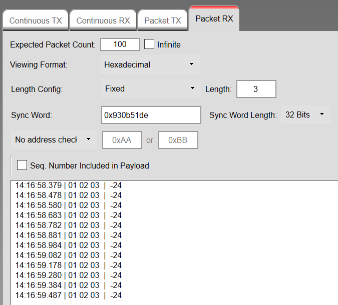

    Send 3 byte fixed length package on Tx.
    Payload is 0x01, 0x02, 0x03
    Packet Rx, it's OK if fixed length is 3.
    Packet Rx at fixed 5 length, 6 or even more longer. CRC is wrong.
    The correct CRC should be 0x303A .
  • How do you know that the CRC should have been 0x303A and not 0x821D in this case ?

    I get the package format from Albin, who used it to test before.
    If set CRC to 0x303A on signal generator, we have test that SmartRF Studio can receive normally.
  • The first you sent was with a 3 byte packet with fixed length and for this I asked: How do you know that the CRC should have been 0x303A and not 0x821D in this case ?
    Then you suddenly operate with a 64 byte long packet with variable length and a different CRC. You write that you use fixed length but the length byte is included in the packet, hence variable length.

    1. If set CRC = 0x821D on signal generator, receive by SmartRF Studio report error. If set CRC to 0x303A, receive is fine.
