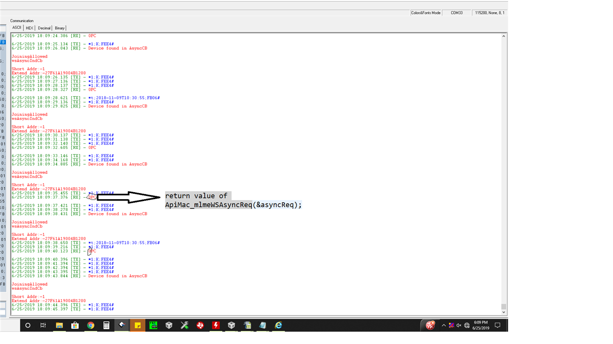

I printing debug message in dataInb_CB function ,it is not received by sensor.
I tested with packet sniffer. Sensor sending PAN Config Solicit frame, it is received by collector. Collector sending PAN Config to sensor and getting Success return value for ApiMac_mlmeWSAsynReq(&asynReq) function. it is not received by sensor.
In packet sniffer i am not getting PAN config frame which is send by collector.
Why sensor not receiving PAN Config frame which is send by collector???
maybe the sensor is rejecting them, Do you not get anything at the callback on the sensor side?
