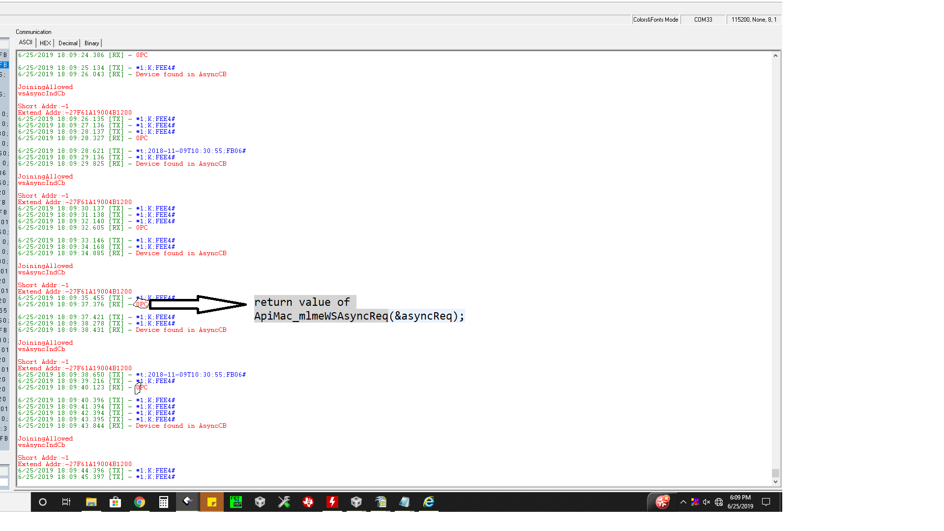

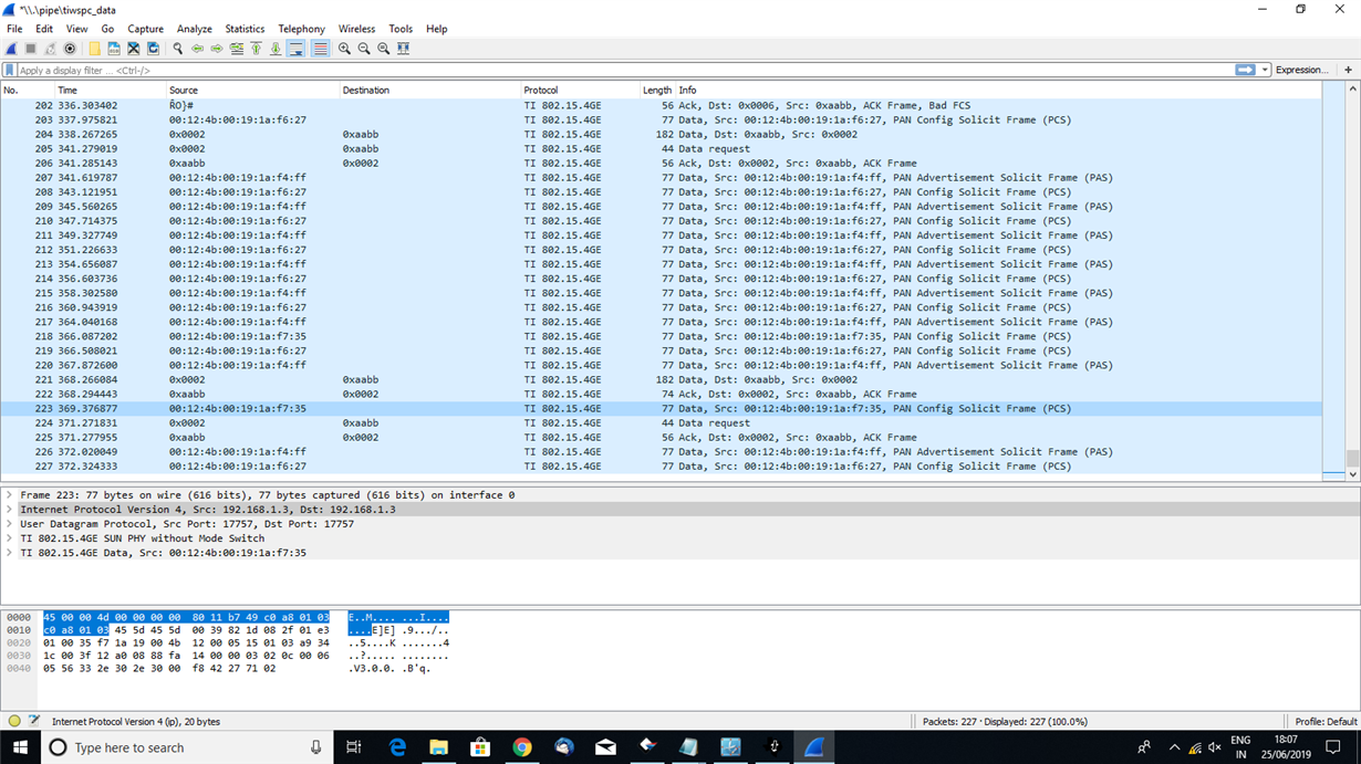

    and we use  packet sniffer to check where the data is missing.
    Here
    we conducted following test
    we paired 10 sensors and power off the collector and on after 5 minutes.
    then sensor is sending PCS
    collector receives that and send PC  and checked the return value of  ApiMac_mlmeWSAsyncReq(&asyncReq); as success in collector log but in packet sniffer that Packet is not seen and even sensor does not receive. I am attaching the following to the above statements
    Why PC from collector is not received by PACKET Sniffer or Sensor even when the collector sends and it gets status as success?
    some times the same happens with association also.
    Thanks and regards
    Haricharan
  • Hi Harichan,
    Did you set a ApiMac_FHAttribute_unicastFixedChannel as requested previously and is your sensor and packet sniffer tuned to this channel?  ApiMac_mlmeWSAsyncReq returning success means the request was correctly transported to the radio layer but this does not indicate that it was successfully transmitted over-the-air or on the correct channel.  Trouble after a restart could indicate a NV memory issue.
    Ryan
