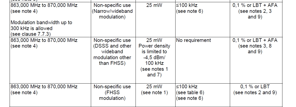

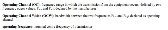

CC1312R: Occupied Channel width for 863 -870 MHz EU Band , is required to set the RBW which is 1% to 3 % of OCW and VBW being 3 times of RBW , there by we can proceed with further testing
Part Number: CC1312R
Hi ,
we are are struck in the pre-compliance testing of our module which contains Texas Instruments Chipset CC1312R
we are in urgent need of the OCCUPIED CHANNEL WIDTH for the EU BAND 863-870 MHZ (ETSI EN 300 220 -1 and ETSI EN 300 220-2) the SUB 1 GHz modules , to proceed for further tests which are mentioned in the ETSI Document for CE certification the OCW value is required which in turn determines the RBW and VBW on the spectrum Analyser
