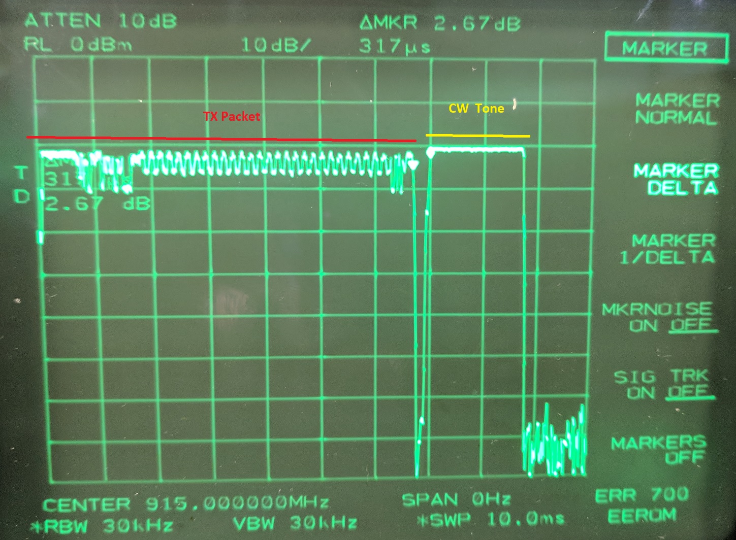

    to mark some events i send a sequence of short 'Tones' with cmdTxTest. The command chain for this is :
    • CMD_FS
    • CMD_TX_TEST with bFsOff = 0
    • CMD_FS
    If i omit the second CMD_FS only the first CMD_TX_TEST works and the second CMD_TX_TEST fails (no TX and runtime of cmd near 0). As far as i have read the documentation the second CMD_FS should not be necessary.

  • Hi Jan,
    If I try your sequence I do not see the same results.
    I have tested the command chaining with .config.bFsOff = 0x0 in the rfc_CMD_TX_TEST_t. The setup transmits a packet every second followed by a CW tone.
    I just initialize the radio once with RFC_setupRadio((rfc_radioOp_t*)&RF_cmdPropRadioDivSetup) and
    RFC_sendRadioOp((rfc_radioOp_t*)&RF_cmdFs) and the run  RFC_sendRadioOp((rfc_radioOp_t*)&RF_cmdPropTx) in a loop.
    See the spectrum analyzer plot in zero span.
