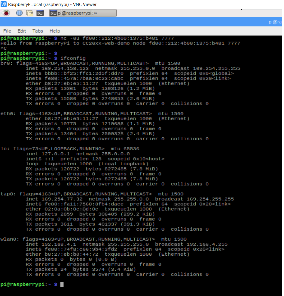

I have 2 Launchpads CC1350, one is a slip radio connected to a RaspberryPi using USB (ttyACM0), and the other is connected to a PC (with Teraterm), and has the cc26xx-web-demo image with the Net-UART flashed to it.
I can send data from the raspberry pi to the cc26xx-web-demo using Net-UART by typing:
nc -6u fd00::212:4b00:1375:b481 7777
in the raspbery pi terminal, and I can receive it on teraterm at the other node.
The Question is how to send a message from the node to the raspberry Pi?
I tried configuring the RaspberryPi to listen to remote port by:
nc -6vulkw 1 7777
but I receive nothing when I write a message in teraterm.

  • To which address are you sending to on the node? And, have you verified any message is sent over the air with a sniffer?
  • Also, please post printout of "ifconfig".
    I don't know how to configure an address to send to in teraterm? My 6lbr page shows border router at: Local address : fe80::212:4b00:1375:c101
    I didn't use a sniffer, but I as I previously stated, I verified sending messages from the RaspberryPi to the node:
    ifconfig is here:
    My question is:
    Do you know what should I type exactly in the Teraterm terminal to send a "Hello World" message to the rasberryPi? How should I configure the RaspberyPi?
  • Which IP address are you sending to in your Node's application?
  • As I mentioned in the previous reply, "I don't know how to configure an address to send to in teraterm (Where the node is connected)"
    I'd appreciate, you attach a screen shot on how to configure an address to send to in Teraterm, and specify what should I write in the RaspberryPi terminal.
    The default destination IP address appears to be determined by set_dest_addr() in net-uart.c.

  • SUMMARY OF NET_UART PROCESS
    To Send data from RaspberryPi to node
    1- Open UART terminal on PC connected to the Node
    2- In RaspberryPi terminal, start NetCat (nc) communication with the node:
    # nc [options] [Node's ipv6 address, as in sensors list table in 6lbr web page] [REMOTE_PORT]
    # Type message then press ENTER
    Hello world from Collector RaspberryPi!
    To Send data from node to RaspberryPi
    1- get br0 IPv6 address and set it as Remote IPv6 in http://[<ip6 address>]/netu.html (use ifconfig )
    2- In RaspberryPi terminal, start NetCat (nc) listening to REMOTE_PORT:
    nc -6ulkw 1 7777
    3- Open UART terminal on PC connected to the Node
    3.1 - from Edit menu, choose "Past <CR>", type RaspberryPi ipv6 address and press OK to get: Updated remote address bbbb::bf25:ffc1:2d5f:dd70
    3.2 - from Edit menu, choose "Past <CR>" again, type message then press OK
    Hello world from CC26xx-web-demo Node!
