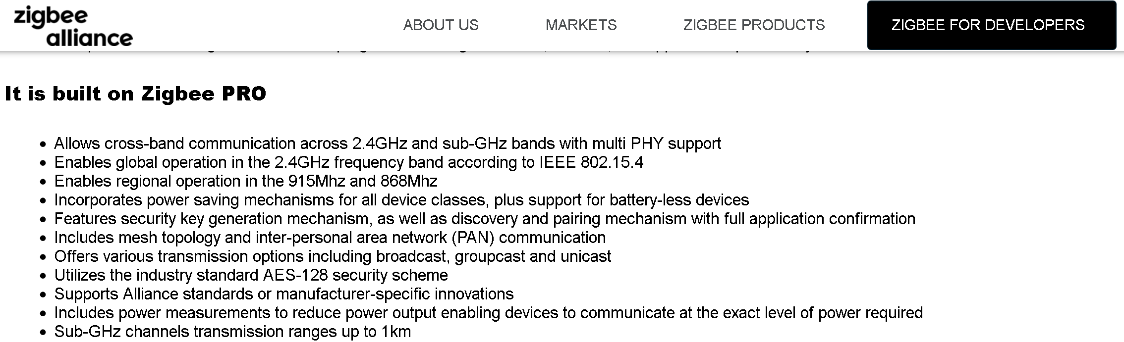

Our Zigbee core as provided in the latest CC13x2/26x2 SDK is R22 certified with the 2.4 GHz PHY: http://www.ti.com/tool/z-stack
Zigbee spec defines sub GHz but TI Z-Stack doesn't support sub GHz Zigbee protocol.
