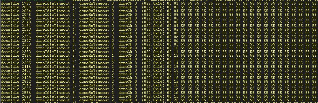

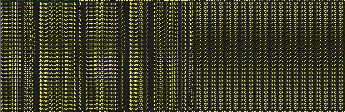

  • Thanks for your reply.
    I have another question.
    I took the original rfWakeOnRadioRx example and just added the output of statistics and the received packet to the UART.
    When the packet is received correctly, I have never seen the counter increment "worStatistics.doneOk"
    Although the rxStatistics.nRxOk counter is incremented when the packet is accepted.
    Why it happens ?
