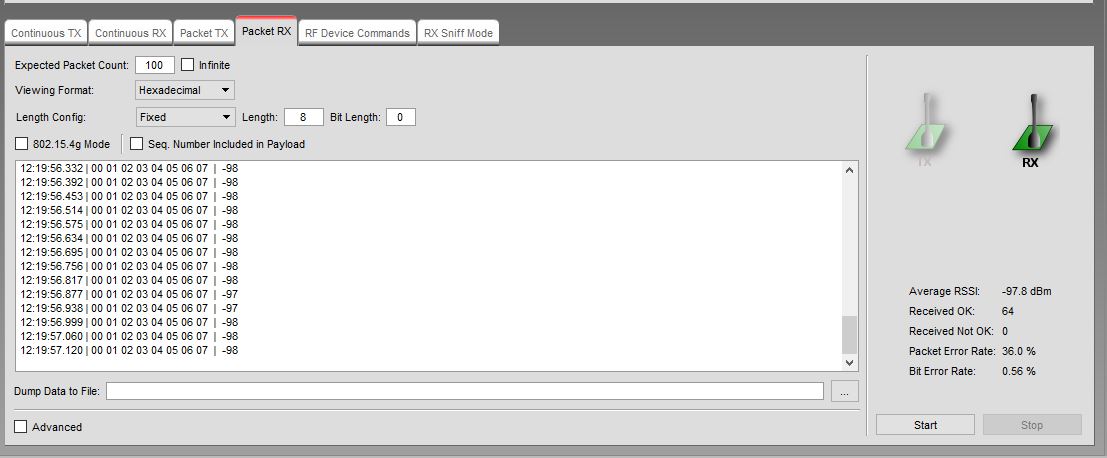

    I did a test with SmartRF Studio and had no issues getting the correct data with packet length 0x8.
  • yes,
    there is no problem when use 2 1200DK communication.

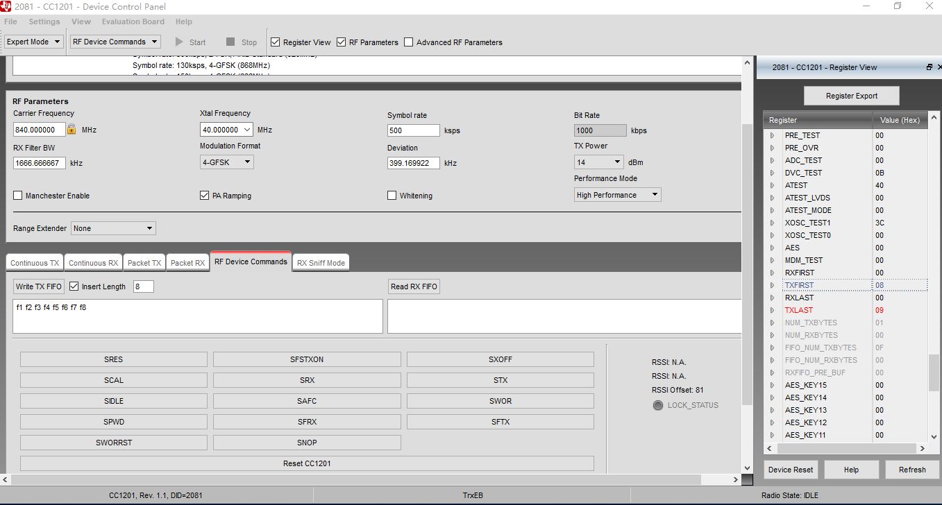

    Could you show with screenshots in detail how you do this?
    As you see, the number of bytes in the TX FIFO is 8, the packet length is also set to 8.
    If you get a FIFIO error in RX you read the wrong number of bytes.

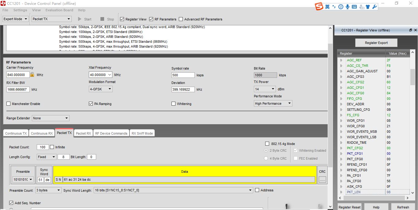

  • Turing off "add seq number" makes it a bit easier to see what is going on. But this shows that you have a packet length of 8 and hence the PKT_LEN should be set to 0x8. And how does that look on the RX side?
    Why do you use only 2 byte sync?
  • Any progress?

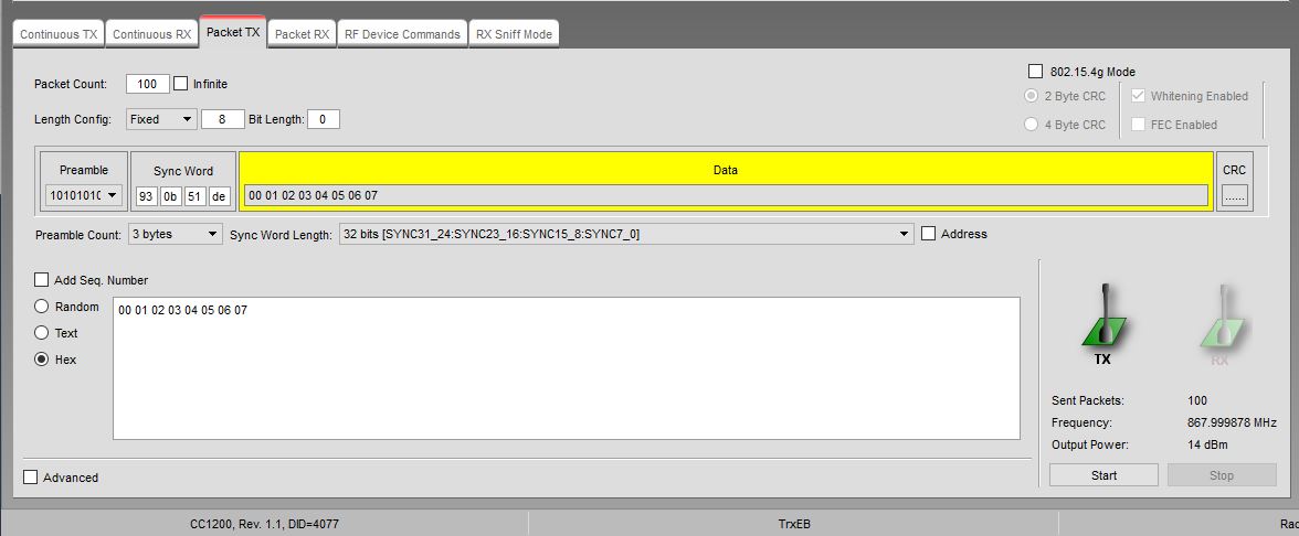

  • the picture above is mistake.
    as according to the register value. we use 4 bytes as sync words: 93 0b 51 de .
    we use oure code(our designed cc1201) to send the data to the rx(cc1200DK).

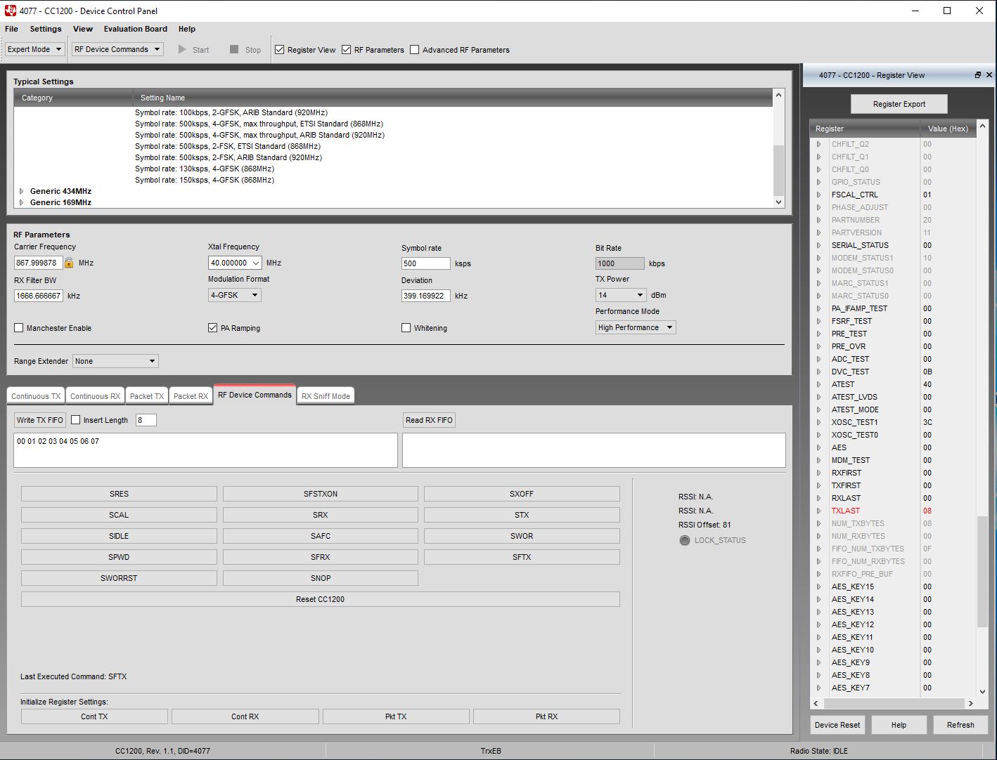

  • I have taken the cc120x_easy_link example and modified it to use the 500 kbps settings from Studio and fixed packet length.
    Below are my register settings and the  modified RX and TX functions:
