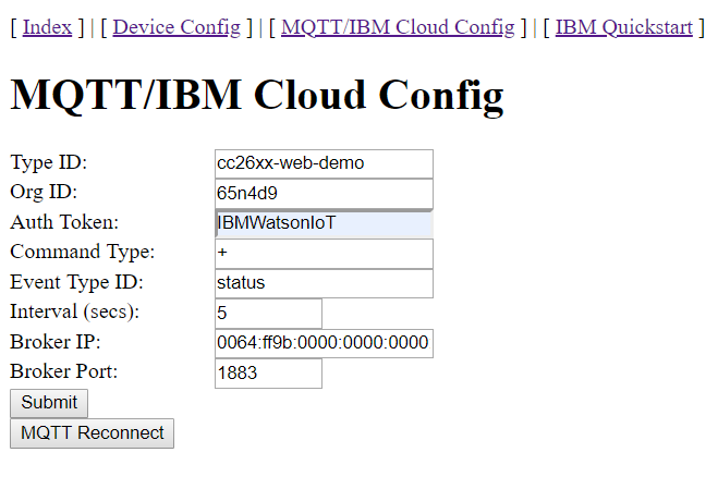

How to get the broker IPv6 address given that my IBM https://65n4d9.internetofthings.ibmcloud.com/ ?
When I ping I get:
ping 65n4d9.messaging.internetofthings.ibmcloud.com
Pinging us.messaging.internetofthings.ibmcloud.com [169.48.234.212] with 32 bytes of data:
Reply from 169.48.234.212: bytes=32 time=67ms TTL=54
If my ipv4 address is 169.48.234.212, how to change it to ipv6 to write it in cc26xx-web-demo MQTT configuration page?
  • The ipv6 address of 169.48.234.212 is mapped to 0064::ff9b::0000::0000::0000::0000::a930::ead4

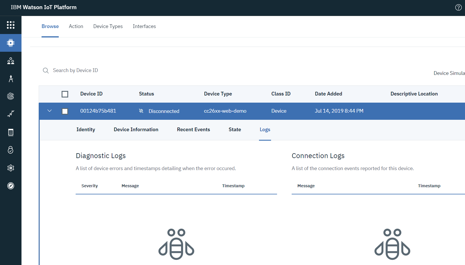

    The node still cannot connect, please check the following Debug Log of the MQTT process:
  • I suggest you to do more printf in MQTT connection to know exactly what happens.
  • Well, I suspect the Ipv6 address or the ibm setup more than the code, the code works fine for MQTT on Raspberry Pi.

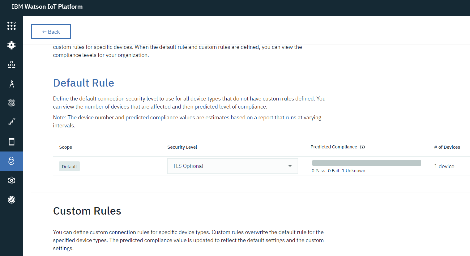

    - Whenever I ping ping 65n4d9.messaging.internetofthings.ibmcloud.com I get a different ipv4 address. Why is that happening?
    - Why "predicted compliance" on the IBM page show unknown instead of Pass or Fail?
    - is it normal to get org id as "65n4d9" instead of "uc6bmi" ?
  • I think it’s normal to get org id as "65n4d9" instead of "uc6bmi".  “What do you mean “Whenever I ping ping 65n4d9.messaging.internetofthings.ibmcloud.com I get a different ipv4 address”? I had suggested you to do more printf in MQTT connection. Do you try it and get more information about connection issue?

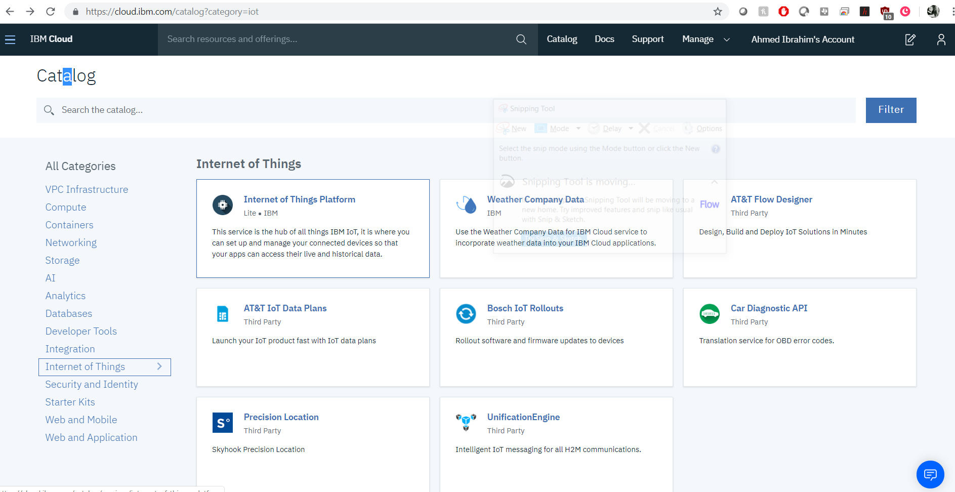

  • Do you have a guide how to create an IBM organization (how to get this webpage: 65n4d9.messaging.internetofthings.ibmcloud.com ?
    I think this is the only thing not found on the blog and hence I might have done sth wrong
    Here is what I did:
    I chose Internet of Things Platform
    and I didn't change anything here...
    Is that correct?

    - Is there a way to connect to the url directly without having to do the ip conversion? Is it implemented somewhere in contiki?
    - Are you able to ping your organization url and get a constant IP every time?
  • - Is there a way to connect to the url directly without having to do the ip conversion? Is it implemented somewhere in contiki?
    I have no experience on this but you can try to use resolv_lookup to lookup IPv6 address of url
    I think it's the same when I test this.

  • Thanks, doesn't work either ...
    The TCP dump on port 1883 shows nothing being transmitted : sudo tcpdump -i br0 -v -X port 1883
    I'll just try to get the quickstart working, do you know what should I write in the MQTT config page?
    Org ID:
    Auth Token:
    Command Type:
    Event Type ID:
    Interval (secs):
    Broker IP:
    Broker Port:
