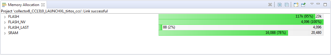

I am using to Transmit and receive data using CC1310 chip in Frequency hopping mode. For that, I am using Collector example from simplelink_cc13x0_sdk_2_40_00_20. The attached image shows the memory allocation of my firmware.
I also need to store some data into Flash memory to use in my application. I am using the following code to store the data into the flash
