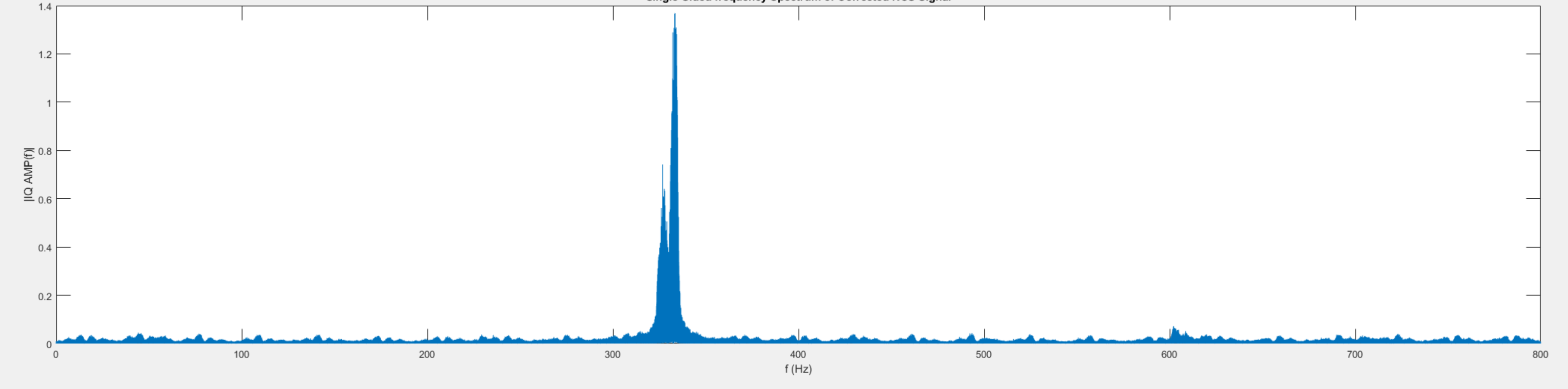

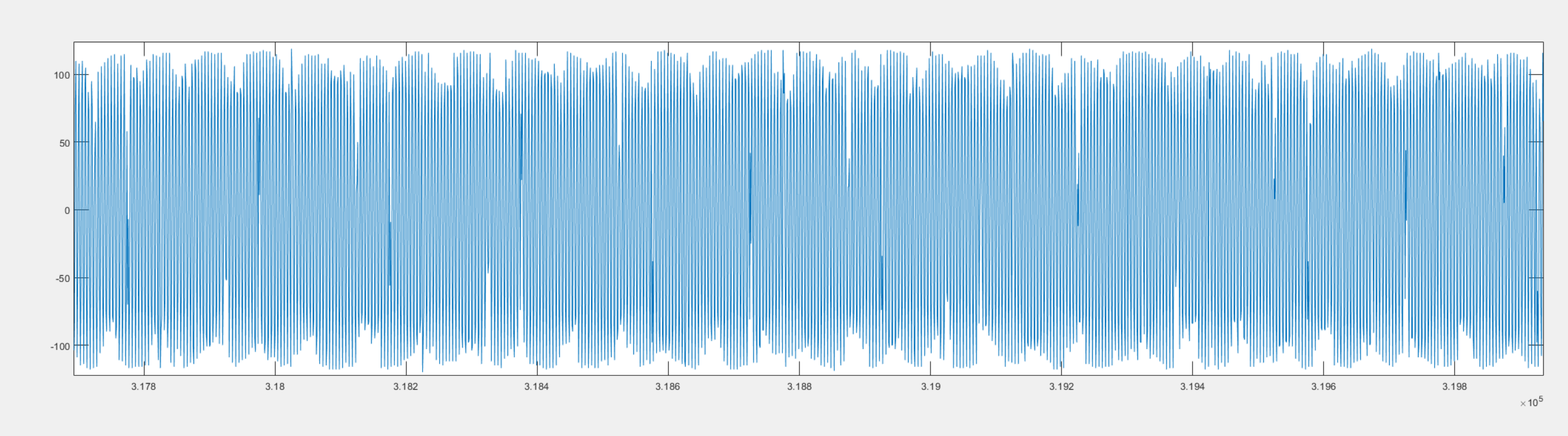

2. I recorded some I/Q samples and do FFT for my I/Q recording. I found that my I/Q sample frequency is not stable which drifts. My symbol rate  is set as the following:
.modulation.deviation = 0x4,
.symbolRate.preScale = 0xF,
.symbolRate.rateWord = 0x106, //0x106 -- 400
.rxBw = 0x20,
Could you also please tell me why the I/Q sample rate is different for each recording? How could I fix my I/Q signal frequency?
