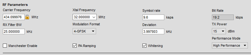

i will use the cc1120 in 433MHz Band with 9600 kBaud Symbol rate, 4-GFSK and 25kHz channel spacing.
I use Data whitening, PA Ramping and the FIFO Packet Mode.
Here my favorite Settings:
Now my Question:
What's the best Deviation for a robust Signal on this Symbol rate?
The examples for 4-GFSK are for faster Baudrates in SmartRF Studio.
Has anyone exerience with it?
