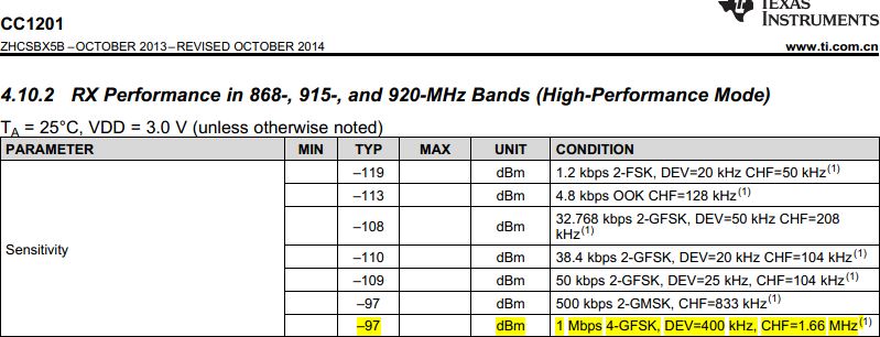

attenuation 100db,so the RX Sensitivity is 14-100=-86db,
the figure above show the 500kbps 2-GMSK,CHF=833kHz
, sensitivity is -97.
why our test is below 11db??
  • You send a 30 byte and have 0 % PER. How do you conclude that you have a sensitivity equal to -86 dBm?
    The sensitivity in the datasheet is measured with a 3 byte fixed length payload and a 20 % PER limit. If you want o compare with the numbers in the datasheet the easiest would be to use the same packet length and PER limit.

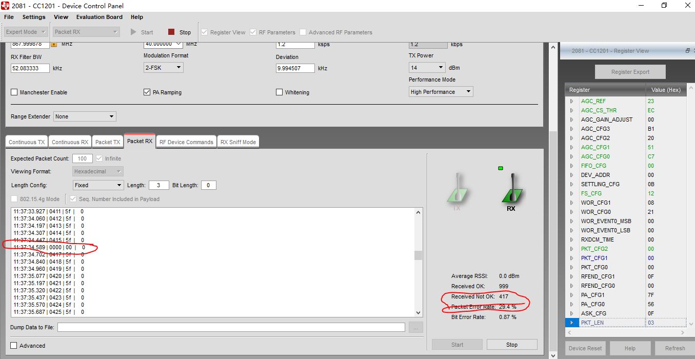

    2. attenuation 132db,
    3. CC1201_dk_B
    Packet RX: Seq.Number included in Payload
    Average RSSI: 0.0 dBm
    recieved OK:  999
    received not OK: 417
    Packet Error Rate: 29.4%
    Bit Error Rate:  0.87%
    [result]
    In the fact, the rx can received corrected 999 packets.
    The PER is 1/1000=0.1%?
    Why the SmartRF Studio 7 show PER 29.4%?  I cannot understand it.
  • This is a bug in SMartRF Studio caused by the sequence number. If remember correctly, SmartRF Studio uses the sequence numbers to calculate the PER and when you in this case fail to receive sequence number 416, Studio assumes that you have lost a lot of packets.
    This was seen in this thread: https://e2e.ti.com/support/wireless-connectivity/other-wireless/f/667/t/637504

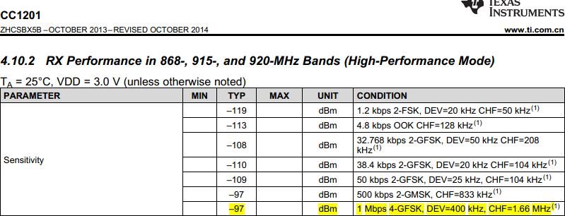

    can we use the -174+NF+10lgB+10lgSNR to calculate the cc1201 receive Sensitivity?
    follow the cc1201 document,
    1) 1Mbps,4-GFSK,DEV=400kHz,CHF=1.66MHz  , -97dbm;
    2)1.2kbps ,2-FSK,DEV=20kHzCHF=50kHz,   -11dbm;
    1).CHF1.66mhz  divider  2).CHF50KHZ is 33.   lg33=1.5,   so the difference sensitivity of 1) and 2) is 10*lg(1.66M/50K) , about 15dbm?
  • Yes, -174+NF+10lgB+10lgSNR can be used to estimate sensitivity. Note that the SNR will not be equal for all datarates and modulation formats.
    Not following your last line since for me it's not clear exactly what you are calculating. Are you trying to use the equation to calculate the sensitivity? In that case, which SNR do you use since the SNR required is higher for 4-GFSK/ zero IF compared to 2-FSK/IF.
