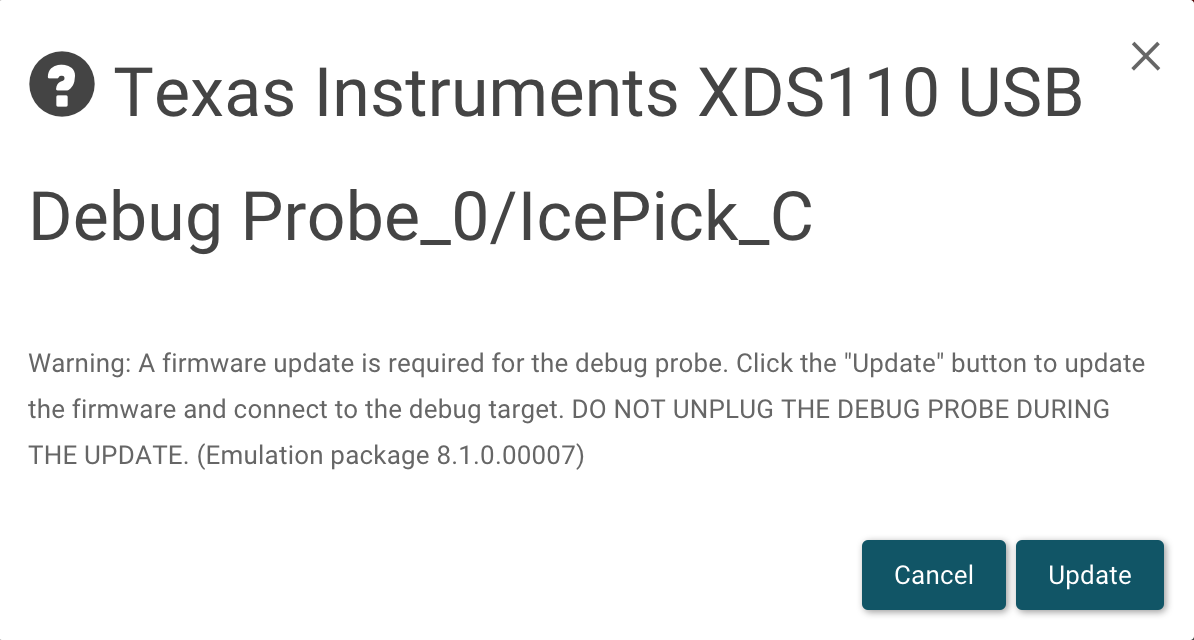

I am working with the newest CC1312R1 LaunchPads and there seems to be an issue between what the latest version of firmware is for UniFlash 5.0.0.2289 and CCS 9.1.0.

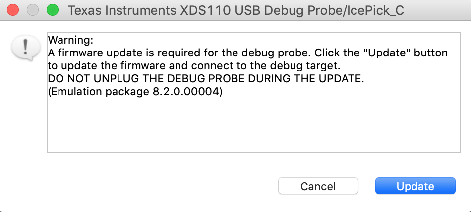

When I attempt a debug with CCS 9.1.0 I am prompted to update the XDS110 firmware.
When I go back to use UniFlash to either erase the chip or upload firmware UniFlash wants to update the XDS110 firmware again.
It seems that there is something about one wanting to downgrade what the other upgraded...

Message from UniFlash 5.0.0.2289

  • In your case I think it will be solved by installing the latest version of UniFlash (v5.1.0). This was released yesterday but for one or the other reason the download page has not yet been updated. Hopefully the link from the product page (Get Software) will be updated within short, in the meantime you could try this link: http://www.ti.com/tool/download/UNIFLASH.
    Øyvind
  • Hi Øyvind,
    Thank you this resolves the issue!
    I now have 5.1.0.2397 (on MacOS Mojave 10.14.6) installed.  UniFlash is no longer fighting with CCS9 to downgrade the XDS110 firmware.
