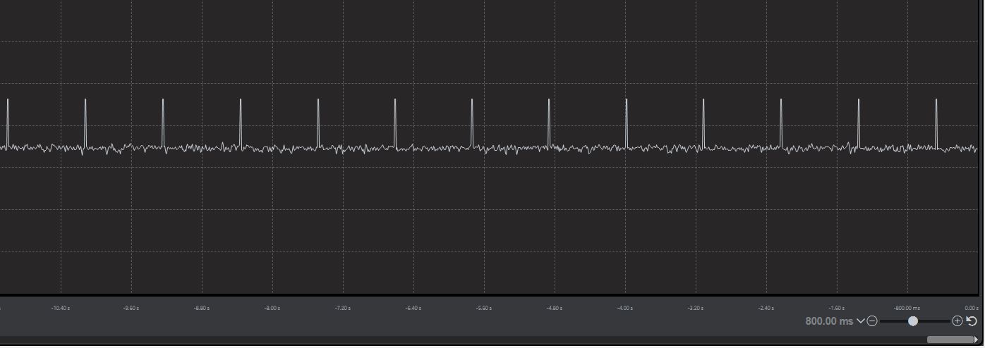

2) Once the processor is in low power mode I see a pulse every 1s around 200uA. I'd like to know what this is and if this can be disabled.
  • Hi Andrew,
    I have replicated this behavior as well and am investigating whether it is intentional or not.  The pulse you see is for the BOD and cannot be disabled.
    Ryan

    Thanks for your reply. The datasheet states an average standby current of 850nA (internal RC LPOSC) which is what I see so the BOD duty cycle is not a problem for me.
