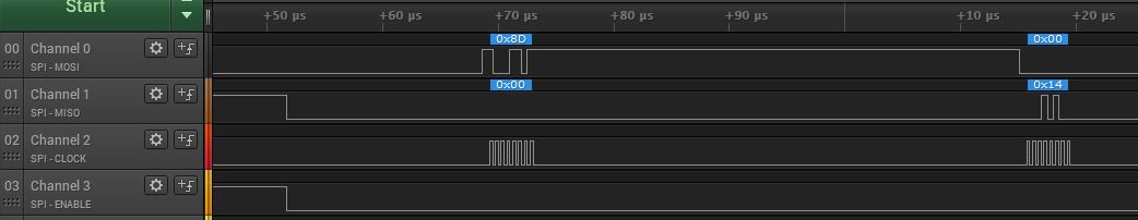

I can read the default value from the CC1120 registry that is used for configuration. Then I try to write a different value in it. After reading again, I still get the default value.
I am using STM32VLDISCOVERY. I can read the value, so the configuration of communication via SPI is correct.
Of course I know that the write address is given unchanged, for reading increased by 0x80.
Anyone have an idea what's wrong?
    Which specific register are you trying to write to? Have you used a logic analyzer to verify what is actually happening on the SPI bus?
    Fredrik
  • Hey,

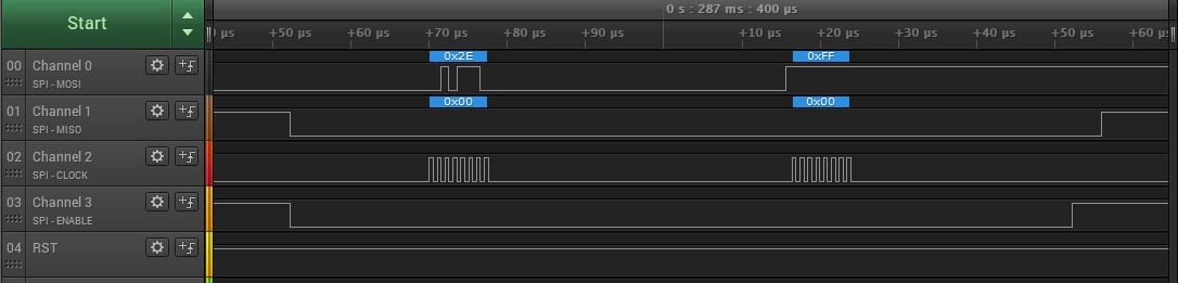

    the first picture is sending the value 0x18 to the PREAMBLE_CFG1 register. In the second picture there is a later reading of the value of this register, which has not changed and is the default 0x14.
    Interesting: when I write bytes into the TXFIFO register and then read NUM_TXFIFO, I can read how many bytes there are in FIFO, but two bytes less than I wrote.
  • Please make sure that the SPI timing is according to the SPI spec. in the data sheet when it comes to rise time, hold time etc.
    Also, make sure that the radio is in IDLE when accessing the registers.

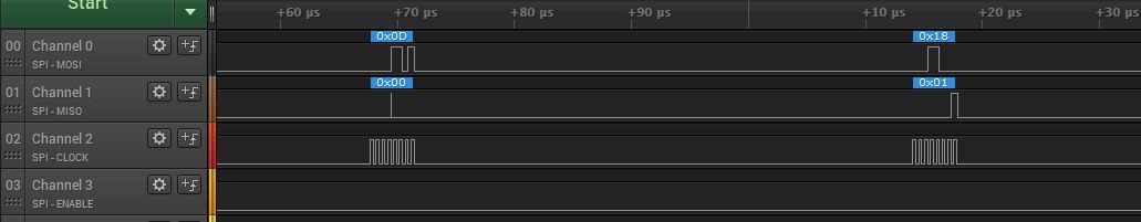

    There are some noise on the MISO line? Where does it come from?
    Below is a plot showing how 0x18 is correctly written and read to the register at address 0x0D:

  • I compared with time requirements and it's ok. The device is in IDLE when I want to read and write.
    The disturbance on MISO was some one-time garbage, it doesn't appear again.
    The strange thing is that each register can be read correctly. Writing to TXFIFO is also correct, subsequent NUM_TXBYTES reading shows the number of bytes saved. That is, the TXFIFO register entry works.
    I can't save anything to other registers.

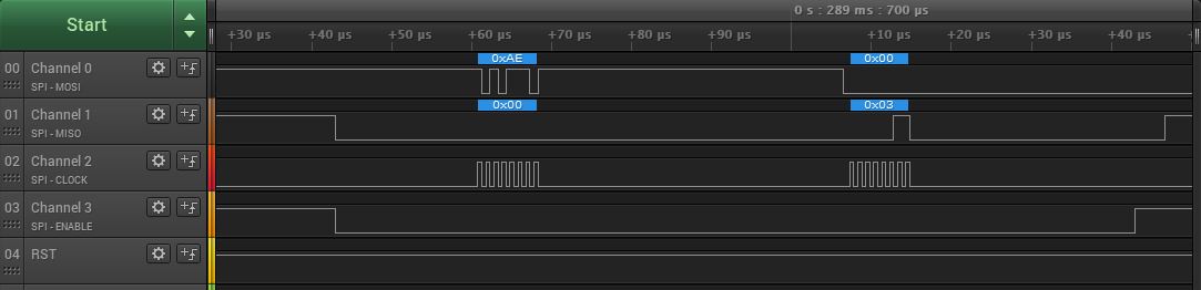

  • Here attempt to write and read later from the PKT_LEN register. Does anyone have a solution for this?
  • I am afraid it is difficult to help when we are not seeing the same problem here. Have you used a oscilloscope to measure all the timing to see that it is OK according to spec?
    Can you please do the following sequene and show everything in on plot, so that we are sure that there is not something happening in between SPI accesses:
    SRES, write to PKT_LEN, read from PKT_LEN.
    Also, are there any other devices sharing the same SPI bus?
    Siri
  • It turned out that the problem was STM (despite the correct runs on SPI), I connected a new one. Now write registers working properly.
