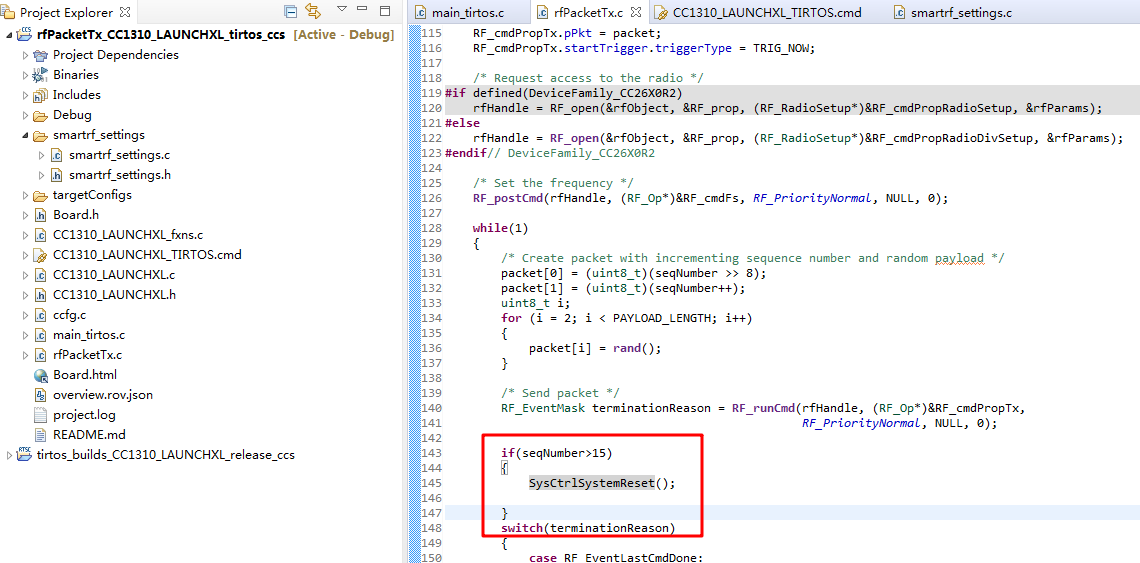

How to reset CC1310 by software? Is there a example code about this software reset?
Here we did, call SysCtrlSystemReset() as below picture.
But CC1310 is blocked and no reset happen when we test it in step by step debug mode.
Even can't be recovered by watchdog.
