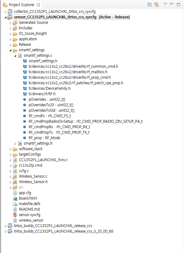

    I success connect my board and SmartRF Studio by JTAG
    and made RF Configuration setting file by SmartRF Studio(smartrf_setting.c, smartrf_setting.h)
    And there are used my application(My project are ti154stack/sensor and collector)
    But Sensor Project is not support smartrf_setting.c and .h basically
    I made new fold 'smartrf_settings' in my project fold ant files save in smartrf_setting fold
    Try Compiled but compile error(reference blow picture)
    I don't  find anywhere "RF_cmdPropRadioDivSetup" and "RF_cmdFS"
    And Error mark is displayed project name and not displayed anywhere (view first picture)

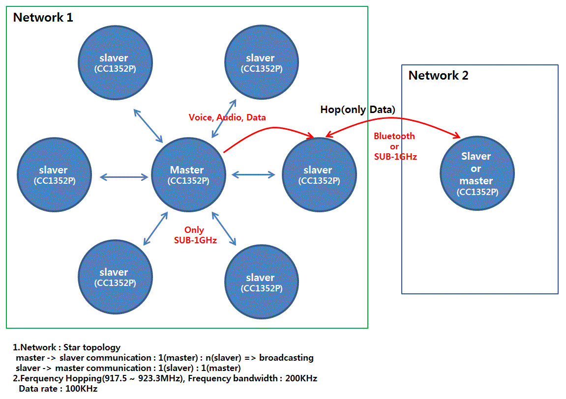

    I ask about sdk(example sensor & collect project) for make wireless system(star topology)
    Refer to below
    I want develop system like below.
    Used Item
    Model Name : CC1352P
    SDK : simplelink_cc13x2_26x2_sdk_3_20_00_68
    CCS9.2
    My system is broadcasting(reference below picture)
    So i want your recommend method(example project) and current, i developed used example project are sensor and collector of ti154stack
    But i feel limit that
    My system is possible develop use by simplelink sdk,
    if it is possible, recommend to me how to do it

    Hello sung,
    This application is possible but with a few requirements:
    - Both networks must be in FH mode so that the shared sensor can switch networks without resetting or making various changes to the stack.
    - The node in the second network must be a collector in order to communicate with the shared sensor.
    Here are some further references for your review:
    https://e2e.ti.com/support/wireless-connectivity/sub-1-ghz/f/156/t/707538
    http://dev.ti.com/tirex/content/simplelink_cc13x2_26x2_sdk_3_20_00_68/docs/ti154stack/html/ti154stack/frequency-hopping-mode.html
    If you are still willing to consider BLE for the second network then I highly recommend that you look into the TI 15.4-Stack Sensor + BLE DMM example: http://dev.ti.com/tirex/explore/node?node=ANJs4AXGwTa.sH7rWl.BvQ__pTTHBmu__LATEST
