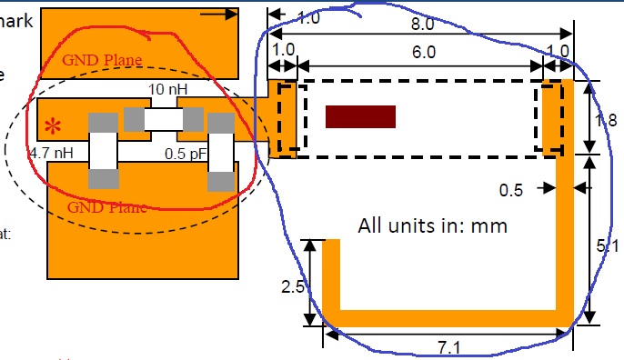

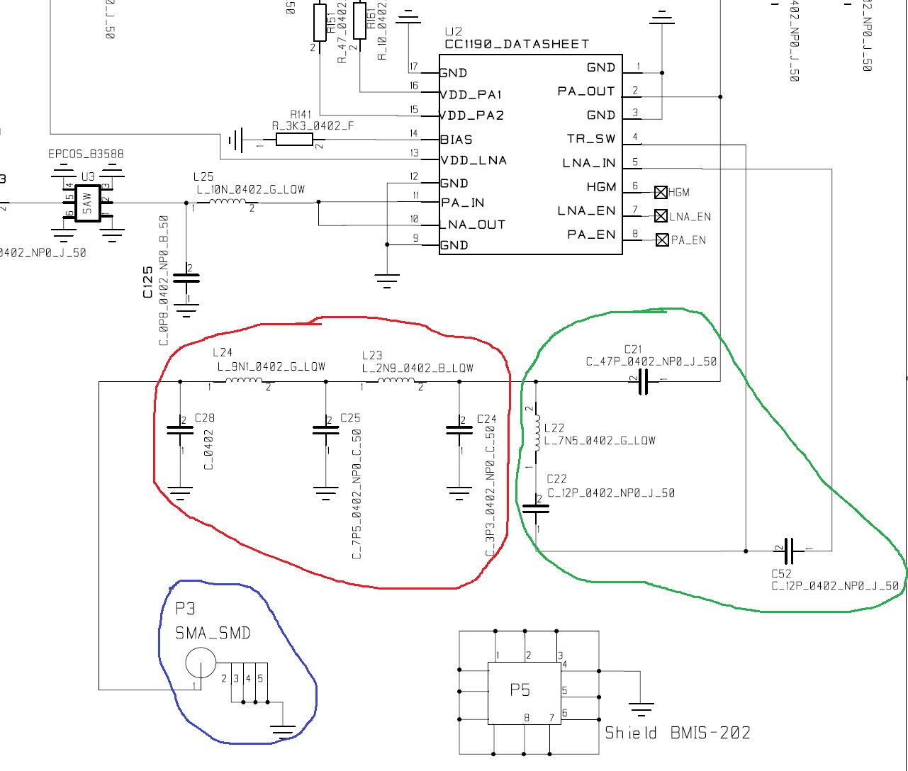

I am trying to design a Sub-GHz system using CC1101 - CC1190 combination.
While designing, I am referring to example design [SWRR077] CC1101-CC1190EM 915MHz Reference Design.
I followed the reference design mostly, except for antenna part, which I have replace with something other than whip antenna due to cost issue.
So, I believe I can finish my design keeping everything same as reference design except for the red and blue part circled part below
For antenna, i chose Johanson 0915AT43A0026.
1. Can I replace Red circled part with pi network, and blue circled part with antenna as shown below?
2. After pi network, should I need "50 Ω feed line" to connect to Green part?
3. Can I keep the values of green part the same as reference design?
Thank you.
