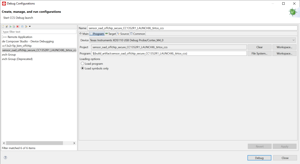

CCS/LAUNCHXL-CC1352R1: Application firmware does not boot (probably erased) after a reset unless the bootloader is flashed AFTER
Part Number: LAUNCHXL-CC1352R1
Simplelink version: 3.10.01.11
Board: cc1352r1
Example project: sensor_oad_offchip
I have tried everything suggested in this related post.
Attached you can see both my linker-scripts:

Question:
My application firmware does not boot after resting the board unless the bootloader is flashed AFTER the Application firmware.
Is there a way to flash the bootloader only once?
