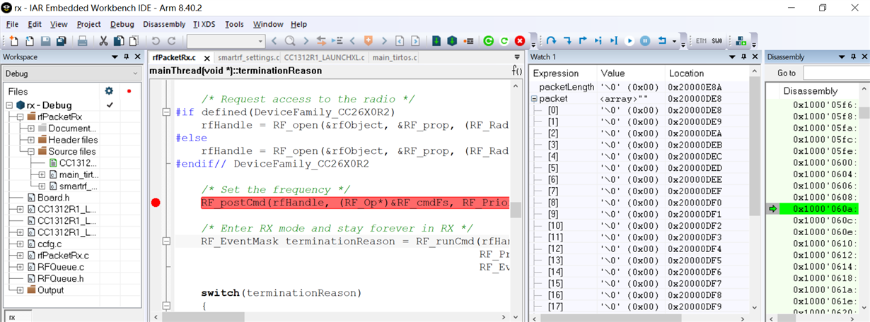

Before using CC1310, now developing CC1312, the code can run normally on CC1312 Lanunchpad, failed on its own board.CC1312 is all 7*7 packages
Please check the schematic for me

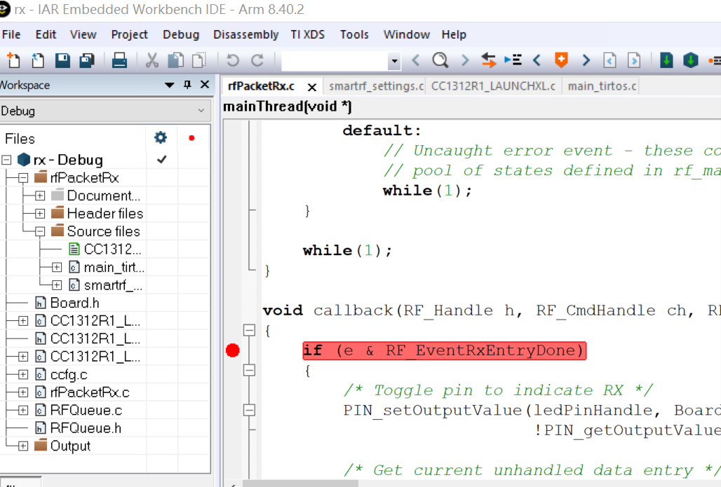

  • The simulation can enter the main function, but the callback fails
    RF_EventMask terminationReason = RF_runCmd(rfHandle, (RF_Op*)&RF_cmdPropRx,
                                                   RF_PriorityNormal, &callback,
                                                   RF_EventRxEntryDone);
  • - Could you confirm that the rfCarrierWave example runs on your board?
    - It's a bit difficult to see from your screenshots: What exactly fails in the callback?
    - Which component is FL2?

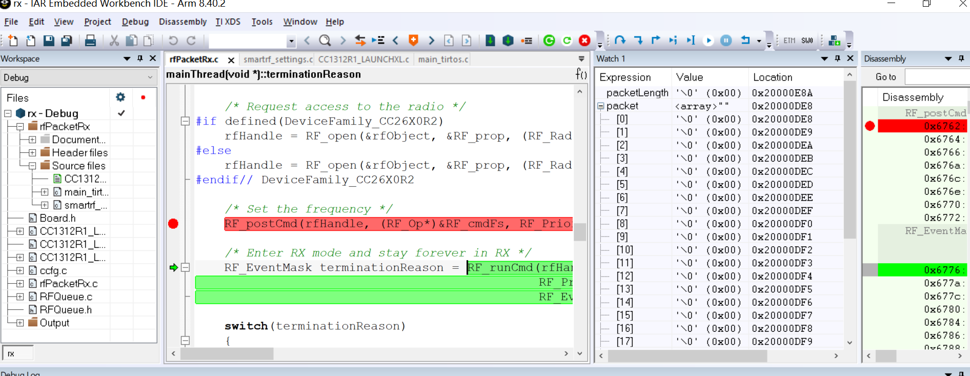

  • With my own board, when I use download and emulation, it is possible to access the main function. However, set Abreakpoint at "RF_postCmd",Run the program,Enter the"RF_runCmd",It can't keep running.
    Today, I welded the CC1312 microcontroller to the development board of CC1310, and the crystal oscillator was also changed to 48M, which still failed to receive the data wirelessly
    I don't know what special requirements CC1312 has for peripheral circuits?
  • Download and simulation, it is possible to enter the main function.
    oday, I used the development board of CC1310 to replace the main chip with CC1312, and the crystal oscillator with 48M, but the wireless still could not receive the data. I don't know what special requirements the CC1312 chip has for the peripheral circuit.
  • If you are using the rfPacketRx example, this will stay in RX forever so the code will not return after RF_postCmd.
    Do you reach the callback?

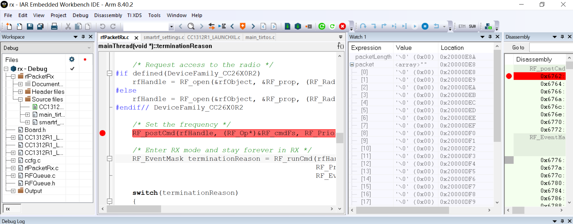

  • Below is the development board simulation
  • receive data. Exit simulation state, serial port receive and receive data normal.
    Below is a simulation of my own board
