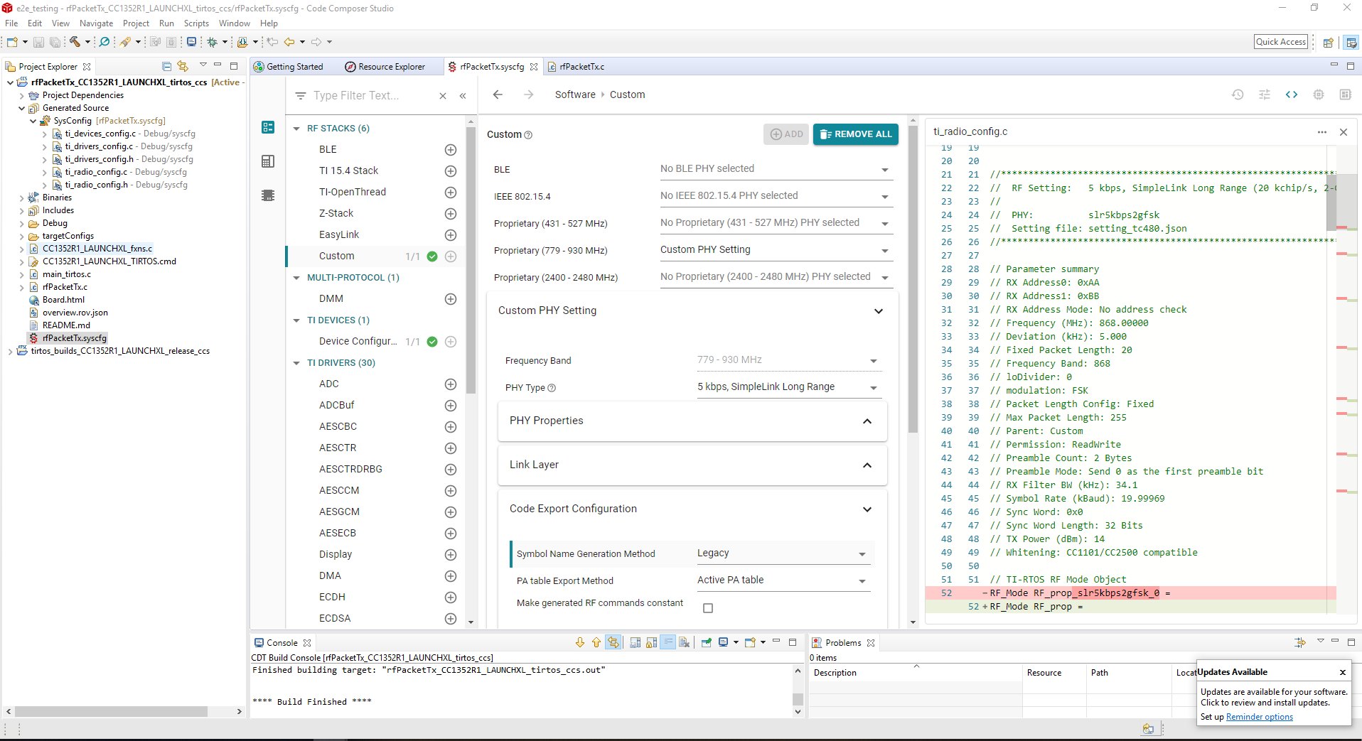

We have an existing project based on PROP_CMDs (50kbps, 2-GFSK, MR) in radio driver. Considering to increasing the transmission distance, we want to migrate to (5kbps, DSSS, Long-range).
I can see many examples are directly using EasyLink API, but are there any examples that is directly using PROP_CMDs so that we can easily modify our project?
Thank you very much,
  • You can use the rfPacketTX and rfPacketRX example and just change the settings from the 40 kbps settings to the SLR settings y ou want to use. This is easy if you use sysConfig in the latest SDK:
  • Hello Siri,
    Thank you very much in advance for your reply.
    I had tested in syscfg feature and it works perfectly! Syscfg is a really handy and useful tools!
    Thank you very much, Have a good day!
    N
  • If you are not using sysConfig, you simply generate new smartrf_settings.c/h files using SMartRF Studio, and you use those files instead of the settings files already included in the rfPacketRx and rfPacketTx example.
