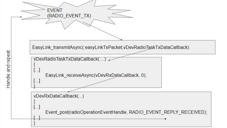

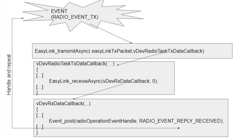

Hello, my goal is to transfer a certain quantity of data (say 128kbyte) on the wireless link using a cycle represented in the simplified (I've omitted all the controls, but trust me, I've added all the controls i could):
So:
- send a command asking for data (fires event on the top)
- Send the data and callback to DataCallback. The call back starts the async data rx:
- When a receive is reached, handle the data (i.e. write on external flash memory) and send another request.
Data packets are small (19 chars on my protocol)
This works perfectly and smoothly for hours if I have 1 packet every 5 seconds. It seems to work with a rate up to 2 packets per seconds, but as I try quicker (i.e. 8 packets per seconds) the board hangs in weird and unpredictble manner, after a certian number of data exchanges (about 15 if I add a delay on the cycle of about 125 ms, about 28 if delaly is around 350 ms)

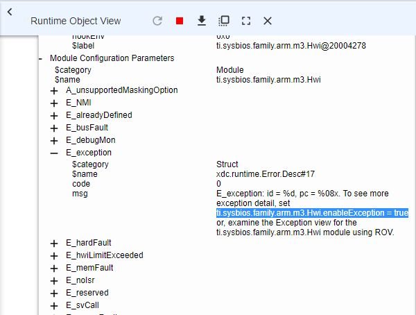

  • Digging over and over, I've found that is stuck into Hwi_excHandler
    which seems to be a problem seen here
    So I've turned on the ROV, but it says:
    So, I've changed the configuration file as shown here:

    m3Hwi.enableException = true;
    But... ROV does not suggest anything new.

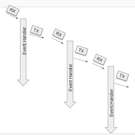

  • Even if I could not find out what was the exception during the packet exchange I've found what the issue was.
    The task calling for the async packet send was busy for a long time after data send, so there was an overlap and this was a possible issue:
    Best regards!
