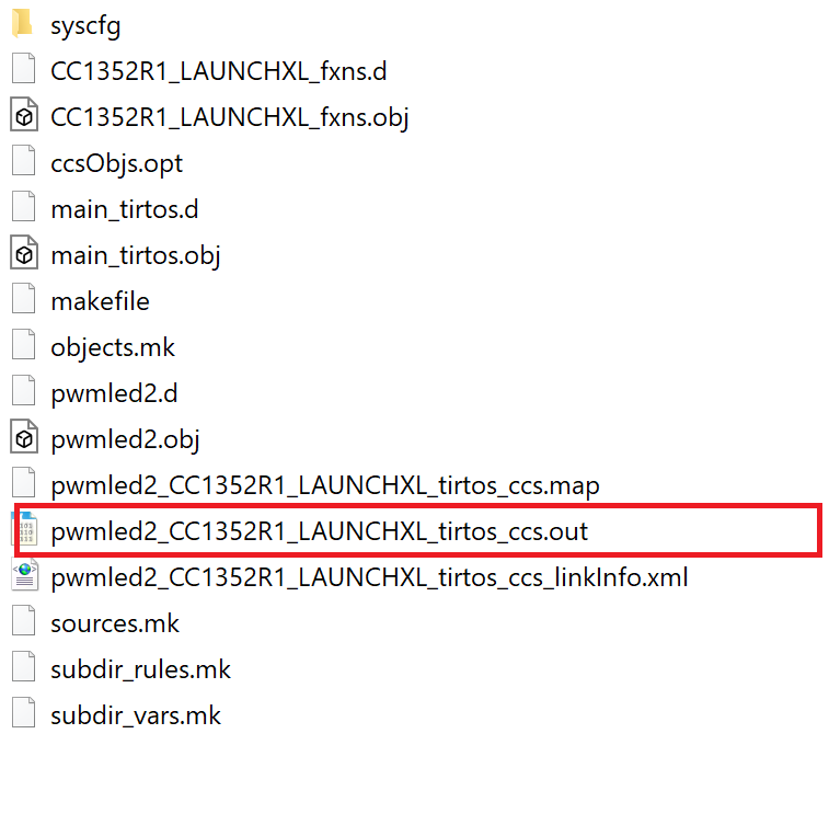

Step 1: I build project in ccs (unlike the tutorial, I don't see the file ccfg.c):
Step 2: I get the Firmware Image:
Step 3:

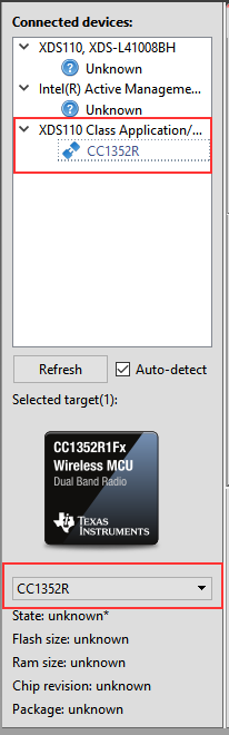

I can to flash the image from Uniflash to the CC1352R via XDS110 USB, but can't achieve the same using the UART / BootLoader.
I start by erasing the entire flash from Uniflash's "Settings & Utilities" (Manual Erase, Erase Entire Flash) via XDS110 USB, and then manually select the device as 'CC1352R (BOOTLOADER)' before to loading the image.
Then, I follow the 8.2 in the document slau799b and I set my COM port and Image Valid Address as 0x00000000 for the CCGF from "Settings & Utilities".

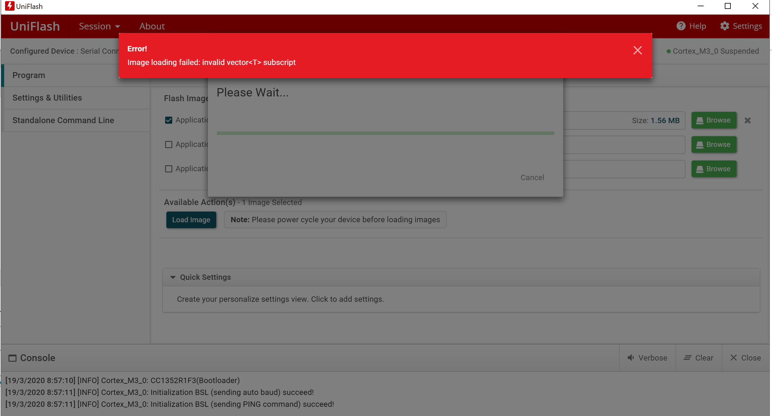

When I load Image, the error message I get is:
And if I click "load Image again", I get the error following:
What happen?
How can I solve that?
