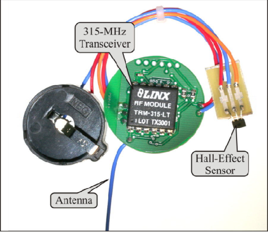

For a project with a university, I would like to design an antenna that transmits at 868MHz under water. Froma related work:
Taylor, H. D., Anton Kruger, and J. J. Niemeier. "Embedded electronics for a mussel-based biological sensor." 2013 IEEE Sensors Applications Symposium Proceedings. IEEE, 2013.
I found following details:
- The wavelength of radio waves is around 1/9 in water compared to the one in air
The group has just used a wire with 2.6cm for their 315MHz antenna, see below:
For 868MHz, the wavelenght is around 34.5, a standard 1/4 wavelenght antenna would be 8.62cm long. Since the wavelength in water is reduced by 1/9, I could simply go for 34.5cm/9=3.8cm
For a simple wire antenna, what should be considered?
- How large should the ground plane be?
- Is a matching circuit recommended?
- Is a 50Ohm microstrip line recommended?
thank you a lot for your help!

    Water has a high attenuation of RF signals in the MHz range, so evaluate first if RF is a viable option for transmitting your data under water. As far as I know, there are not many commercial uses for RF signals under water.

    Thanks a lot :). That's for sure a good question but I just need to bridge 1-3m in water and it's a research project. RF is preffered compared to ulrasound or light since there are more convenient modules etc.

    Ideally you should have a matching circuit, but i think it will be very difficult to connect a network analyzer to properly tune it with the correct conditions under water with epoxy casing.  The ground plane should be at least a quarter wave in each direction from the antenna. Try to keep everything as close to 50 ohm as possible.
