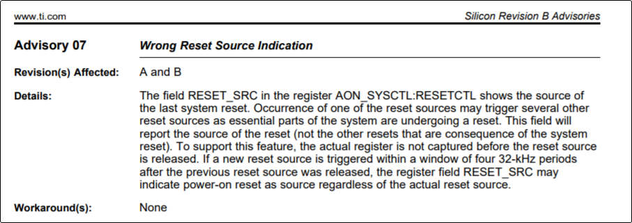

  • From your descriptions I can't see any obvious reason for the behavior you are seeing.
    x-ray sounds like a good start to get some insight in how the module "looks like". It could be useful to compare a "good" module with a module where your customer has seen issues.
    In addition the following errata note should be noted:
