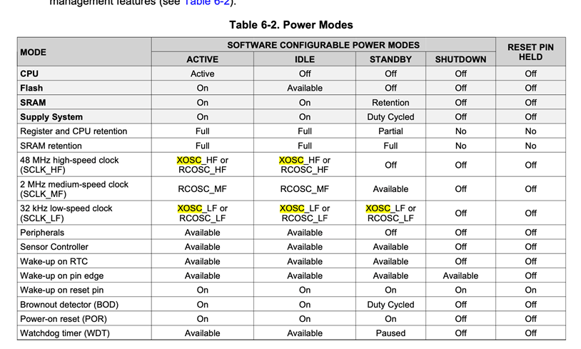

I was trying to make the CC1352P enter standby mode. I suspended all tasks and then i measured ~0.5mA which is what should get when the processor is in Idle mode.
  • The clock in my system is: CCFGREAD_SCLK_LF_OPTION_XOSC_LF
  • So in function  Power_init()  the driver choose to disallow standby mode and sets it: Power_setConstraint(PowerCC26XX_DISALLOW_STANDBY);
  • When the driver should change its power mode in function PowerCC26XX_standbyPolicy() it cant enter standby and therefore doesn't run the line : Power_sleep(PowerCC26XX_STANDBY);
This is not the whole story. In TI's datasheet SWRS192C there is the following table, which shows that in standby-mode the 48 MHz clock is off, meaning M4 is off, and that is what i wanted. It doesn't mention and limitation on entering this mode.
So what am I missing and I need to do in order make the processor enter standby-mode?

  • Hi Adi,
    You are correct in that Power_init() sets constraints, these are however released again as the clock qualifiers etc. are done.
    You should get closer to 600-700mA when the CPU are only in idle. numbers below that most likely mean there is peripherals running and not the CPU per say. Generally when working with TI-RTOS, you don't need to do anything yourself to go into standby. If possible to enter standby (possible being from the SW point of view), then it will enter standby.
    Consider what you do in the tasks that you "suspend". For example, leaving the UART driver "on" in a non-blocking RX could for example prevent you from idle, no matter if your tasks are blocked or not. To fully enter standby, most drivers used also need to be idle/not in use. I would recommend you try out the pinStandby example. This is a good example to use to test and verify that your measurement setup is ok.
    The constrains are indeed set during Power_init() but they are never cleared. I see them during the FW's steady-state.
    My original question referred to measurements of 580uA which fits your numbers of IDLE mode (and the driver configuration that i see).
    Again, according to your documentation the processor should be able to get into stand-bye mode.
    What is expected to happen at clock qualifiers?
    When the clock qualifiers run/being set?
    What should i do to make them run?
    When I cleared the DISABLE_STANDBY at the end of my boot, and closed the tasks i saw 300uA. That is indication to standby-mode and peripherals which are not shutdown properly.
    Any ideas why my FW stays with DISABLE_STANDBY  ?

  • Hi Adi,
    The qualification step could be seen as "wait until clocks are ready" step. For example, if you have set the device to use XOSC_LF, the driver would wait for the HW to inform you that the clock is "OK" (this is a simplification).
    This is something the power driver does during the init call (which is usually done at the beginning of main) as it also controls the clock switching in the application. You should do nothing in regards to this, the driver takes care of it all.

  • Hi Adi,
    The release is part of the expected interrupt signaling that the qualifiers are done:
    oscillatorISR -> disableLFClockQualifiers
    I very much doubt there is something wrong with the example template as such. It is more likely that it is related to your installation path. Could you maybe share some information on which SDK you are using , what errors you see when building and which tool chain you use.
    "The thing is that power_init should have finished its business without DISALLOW settings, even when i am running with CCFGREAD_SCLK_LF_OPTION_XOSC_LF configuration."
    This is not true, it needs the settings as the device needs to stay out of standby during the qualification. Could you maybe share exactly how your main is setup?
