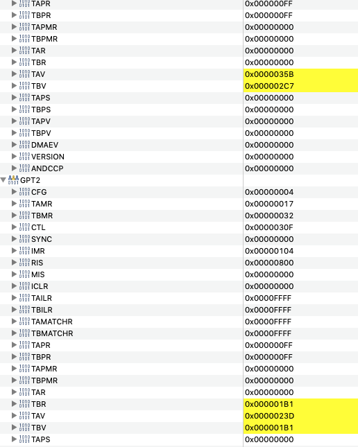

  • I am setting a break point in the timeout interrupt callback and then just looking at the TAV,TBV values in the registers tab. It might just be the timing when debugger is reading the registers, although I have turned GPTimerCC26XX_DEBUG_STALL_ON. I'm using the following code to sync, where timer1,timer2,timer3 are in GPT_MODE_EDGE_TIME_UP mode and timer4 is in GPT_MODE_PERIODIC_UP mode.

    This is an example of what I see in the debugger:
    Also is it possible to determine what edge caused an interrupt when using GPTimerCC26XX_BOTH_EDGES?
  • Could you share the full setup of the timers (all together) so the settings behind all this is clear. The behavior of the TAV/TBV register (among some) is slightly different depending on which modes each timer is in. If i knew exactly how the four timers is configured I could give some better insight (sharing an example I could run is even better).

    I tested this out and while it looks like it does not work (by inspecting the registers), I could verify that the reset actually happens by reading out the values in SW. I'm unsure on why it does not update as expected when reading the register from CCS.
    You could try it out yourself and see how it looks for you:
