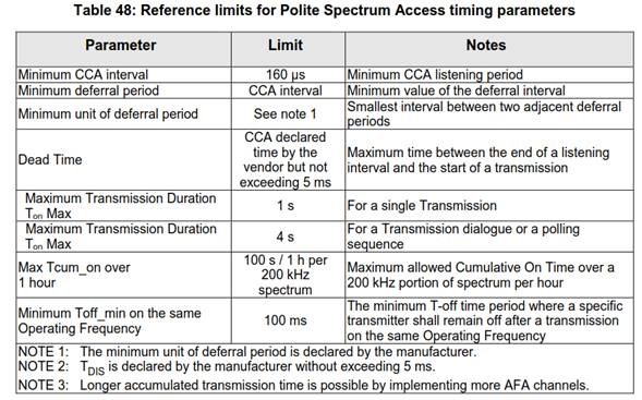

I went through documentation and I additionally checked the settings in easylink_config.h. During certification, we want to use our final software, which mainly bases on the sensor/collector example from the 15.4 Stack, which includes CSMA-CA and LBT. I repost the the table from the EN 300 220 guideline:
According to our certification lab, we have to provide quantitative information (see Annex D, EN 300 220-2). So here my questions:
  1. Is the CCA interval in the sensor/collector example also 250µs, like it is in the easylink example? Or is it 2^3 * 250µs since CONFIG_MIN_BE = 3 ?
  2. What is the deferral period and to what value is it set in the sensor/collector example?
  3. What is the minimum unit of deferral period in our application?
  4. In the easylink example, the dead time is set to 5ms, which is the limit. Can and should we set this to something like 4.8 ms?
  5. What is the minimum Toff_min on the same operating frequency in the sensor collector example? How is this parameter controlled within sensor/collector example? Are message retries fired faster than 100 ms?!
Sorry for bothering you again, but we need this info for passing the tests.

    1. Looking at the questionnaire the following is asked in ETSI EN 300 220-2 V3.1.1 (2017-02) Annex D.2 page 29.
    h) What is the spectrum access mechanism of the equipment? -> Polite spectrum access (My answer)
    i) In case of polite spectrum access:
    • The CCA time implemented by the equipment is ........ ms.
    • The minimal unit of deferral period is: ..........
    • The deadtime T_DIS is ............ ms.
    So what are the correct answers?
    2. Rephrasing
    First, the channel is checked during CCA for 200µs. Then the devices waits for a random time. You now write randomtime (0-Backoff) * unitBackoffslit, and some questions occur at my side.
    • Is unitBackOffSlot the same as the minimum unit of deferral period? If not, what is the deferral period?!
    • Is this unitBackOffSlot 2 ms, since according to your point 3, it is 1 ms + 20 Symbols (@5kbps LRM the symbol rate is 20kbaud/s)?
    • Does the "random" mean, a random value between 0 and Backoff times this unitBackOffSlot? (later you write (Rand (0-BE))) (BE = BackoffExponent)?!
    • This would mean, that 0*unitBackOffSlot is possible which is 0ms. Doesnt this violate the regulation, since the table states that the minimum deferral period has to be higher than the CCA period?!
    • On the other hand, this waiting time could easily exceed 5 ms, which would violate the maximum dead time of 5 ms after the CCA?! (see table)
    • With CONFIG_MIN_BE and CONFIG_MAX_BE, which is 3 and 5, respectively, what is the "Backoff" or "BE" value your talking about?
    According to your point 5, when this waiting time has passed, it does another CCA?! Why? I though this is done BEFORE the backoff/waiting process.
    Now to your point 6, when LBT is active, the channel is checked for 5ms, than the device waits again for "randomtime (0-Backoff) * unitBackoffslot" ms?

    So, if a device sends a message, which is not acknowledged the retry could occur BEFORE 100 ms have passed? I thought this would violate the ETSI guideline according to the table I posted.
    I think the retry due to an occupied channel is no issue, because the 100 ms only apply if the device has actually transmitted something.
