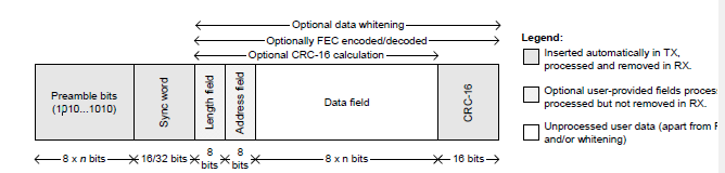

1.Receive and send preamble,sync,data,are they all Manchester codes,
If MANCHESTER_EN position 0,what encoding will be used?

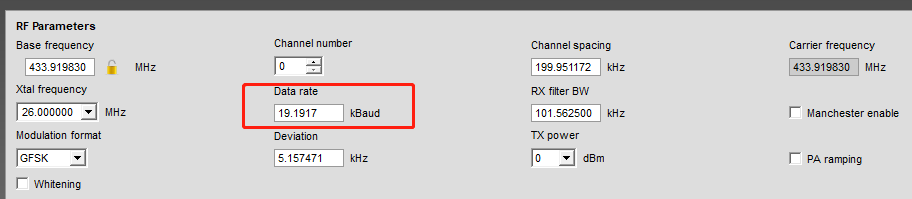

2.Configure the baud rate in the software,Is it configured in Mancunian encoded bit time?
For example, if the protocol defines a data baud rate of 19.2K, should 38.4K be entered here?

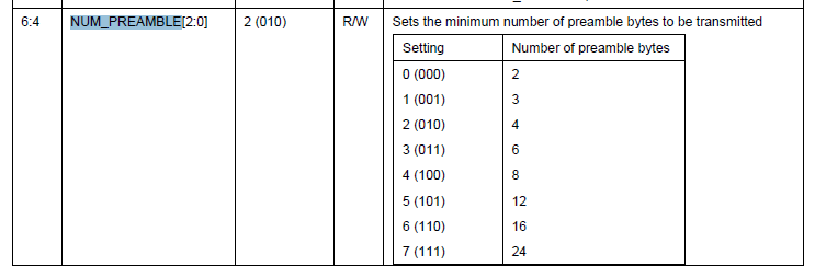

3.NUM_PREAMBLE description, number of preamble bytes, here one byte, is equal to 8 preamble bits?

  • 1: NRZ
    2: From chapter 3 in the datasheet: "Optional Manchester encoding (the data rate in kbps will be half the baud rate)"
    3: Yes

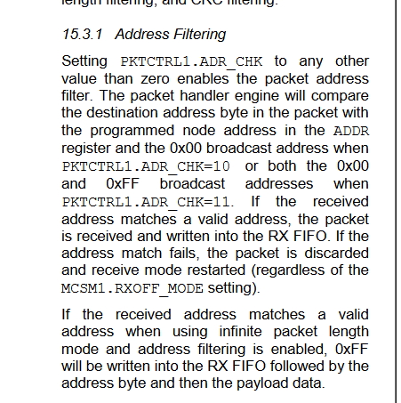

    Address Filtering=0,is error data received,  Address Filtering=1, is no data received,When configured below,
    Please help to analyze what is wrong?

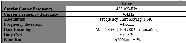

    condition:
    Preamble+sync: 0xFFFFFFFFF6
    Baudrate:19.2kbps
    Encoding:Manchester
    No whitening
    Thanks!
  • What is your setup? Do you have one TX and one RX, both CC1101, using the same register settings?
  • Hi
    No,TX is not CC1101.
    the data baudrate is 19.2k,encoding  with manchester
    Thanks!
  • Without knowing anything about the TX side it's not possible to comment further.

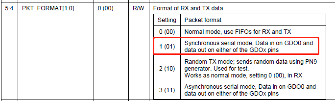

  • Hi
    If set to the following mode,Is the output from the GDOx undecoded or decoded?
    2.NRZ decoding method is adopted,using software to decode data,is it feasible?

  • 1) From the datasheet: "When using the packet handling features in synchronous serial mode, the CC1101 will insert and detect the preamble and sync word and the MCU will only provide/get the data payload. This is equivalent to the recommended FIFO operation mode." From this I believe it should be decoded.
    2) Not sure what you refer to here. No special coding has to be done (If you send '1' you receive '1', same with '0'.
