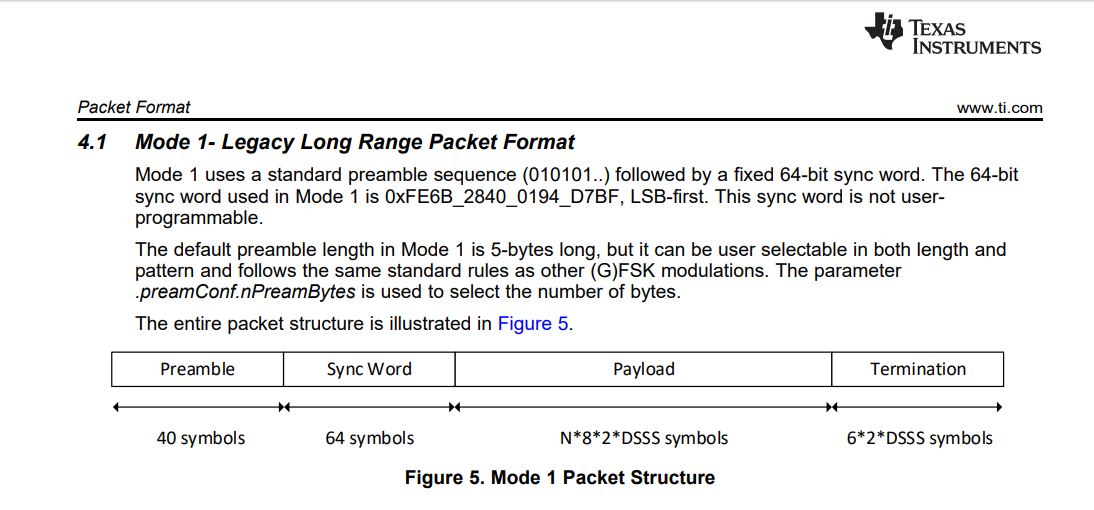

I would like to understand very well those two categories of modes that Ti provides for configuring my transmitted packets:
One mode called : Mode 1- Legacy Long Range Packet Format and Im attaching a photo of ti reference:
So in this mode, what should I configure in my smartRF to use this mode of configuration ? could you show me where's the option for using this mode in my smartRF studio tool? and at which deviation should I configure my smartRF studio for this mode?
Also what's my syncword Data in HEXA this mode use? , what's the payload length in this mode? I didn't understand what's N and DSS symbols that are found in multiplication sum for
length of payload:N*8*DSS symbols...what should its values be(value of DSS, N) ? could you please explain and illustrate all those parameters of mode 1 by an example of transmitted packet with explaining its transmitted data and how it looks once transmitted? thanks alot!
  • What's the CRC in this mode? is it the same as Termination Bytes? thanks
  • How do I check the validation of my packet of this mode if it doesn't have CRC ? thanks alot

    See chapter 6 in https://www.ti.com/lit/an/swra642/swra642.pdf. The sync word in hex is also given in the app note.
    Note that the recommended mode is mode 2.

    lets assume I use mode 1 legacy so my packet data is divided to those catagories:
    first I have the preamble is "0101 ....01" and its length 40bit (written 40 symbol in the photo above) .
    followed by  the syncword which it's s FE6B28400194D7BF, LSB-first (here I didn't understand what does it mean LSB first .. I know what does LSB mean but didn't understand why did he mention that LSB first and what did it mean?) , length of my syncword is 64bit.
    followed by payload Data, here I totally didn't understand what's the length(once again your explanation really wasn't cleared for me)..how do I calculate the length of my payload data? the length of payload is given by this equation which I truly didn't understand its parameters , equation of payload length: N*8*2*DSSS symbols  , what's N and DSSS?
    followed by termination, here is that termination the same as CRC? Im asking because I want to validate packets that transmitted in this mode 1 legacy long range. the length of termination isn't understandable for me, it's given by this equation: 6*2*DSSS symbols , once again what's DSSS?

  • With regards to the packet format shown in 4.1 and 4.2 in https://www.ti.com/lit/an/swra642/swra642.pdf:
    The length byte and the CRC bytes are part of the payload.
    Meaning when you receive a long range mode packet you have to do the following:
    - Search for the sync word
    - When you have found a valid sync word, you know that you will receive the payload until you receive the termination sequence.
    - Decode the payload. The length byte will be the first byte in the buffer and the CRC will be the last 2. You can also start decoding the stream on the fly after finding the sync word and when you have decoded the length you know how many bytes you will receive before you find the termination sequence.
    An inverted sync word is where all the bit are flipped: 0x01101011 inverted is 0x10010100.
  • So lemme to explain what I understand from you, the length of the payload will be the first Byte(8bit) in the payload itself, this means first 8bit(binary) in the payloadData is actually the payload's length ..and the last two bytes in the payload data (last 16bit -binary-) is the CRC bytes? CRC Byte is always 2 bytes if I understand you well..doesn't matter which mode I use mode1/default/mode2 will always the CRC be 2 bytes !
    Am I right? thanks alot for your assistance.
  • Yes, after decoding of the payload the first 1 byte will be length and the last 2 CRC. This should be the same regardless of mode.

  • You know the end of the payload without knowing the length since after the payload you have the termination sequence. Meaning that when you find the termination sequence you know that the 2 bytes you have decoded before this is CRC. ANs also the length of the payload is the first byte you decode from the payload.
  • But I don't know the termination sequence neither its data or its length, so how do I know the end of the payload ? thanks.

  • Termination bits: To get the FEC in a known state. See https://en.wikipedia.org/wiki/Convolutional_code
