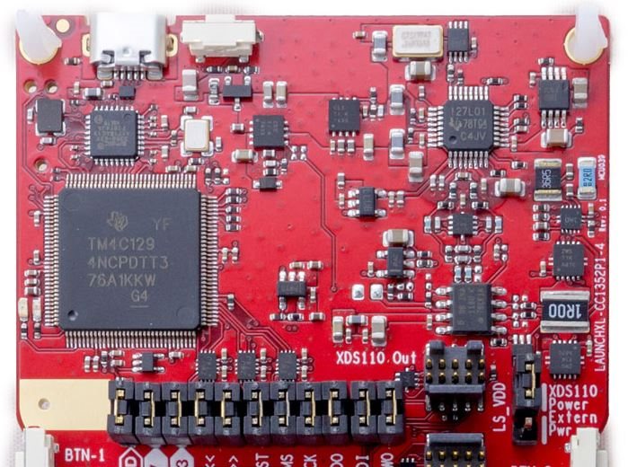

  • Yes, the image is for both the TIVA and the MSP device. Are you able to share the schematic of the XDS and USB chip? Have you based the design on the CC1352P launchpad?
    Vegard
  • Hi Vegard
    Yes, We developed it based on LAUNCHXL-CC1352P-2 Design Files (Rev. A)_swrc350a.

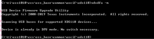

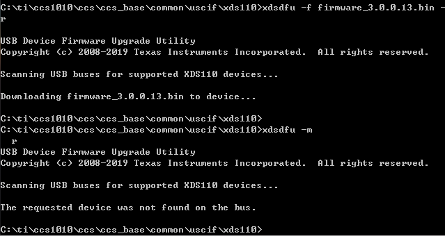

    Please help check the following steps:
    1. Use UniFlash tool JTAG interface to burn boot_loader.bin
    Please refer to the following picture.
    2. After burning the bootloader execute the following commands in cmd.exe
    xdsdfu.exe –e
    xdsdfu.exe –m
    xdsdfu.exe -f firmware_3.0.0.13.bin –r

    bootloader burning is complete
    xdsdfu -m
    xdsdfu -f firmware_3.0.0.13.bin -r
    After the firmware is burned, execute xdsdfu -m and no bus can be found.

  • Hi, sorry for the delay
    To make sure I understand the case correctly. Is this correct?
    On the new device, a MSP432E401Y is mounted. This device is programmed with the boot_loader.bin file found in the XDS folder by using the JTAG interface on the MSP432 chip. When the bootloader is programmed the device shows up in device manager as  "Stellaris Device Firmware Upgrade". By using the XDSDFU utility to flash the firmware_3.0.0.xx.bin the device stops to show up anywhere.
    And the device is fitted with a USB3300 chip between the USB port and the MSP432? If you do a flash erase of the MSP chip and ground the TDO pin of the device, does it show up in the device manager?
    Vegard
  • After looking over the schematic, I think that the whole circuit around the USB3300 chip can be removed. Since the MSP432E401 chip does not interface with anything related to the Energy trace, there is no need for high speed USB. See the debugger on the LAUNCHXL-CC1310 on how this can be done. For the launchpads with integrated Energy Trace there was a need for a higher speed USB to be able to transfer the data from ET.
    If the USB_DP, USB_DM and USB_ID is connected to the respective pins on the MSP device you will also be able to program the device by shorting the TDO pin at boot, to force it into ROM bootloader. This will make programming of the device easier.
