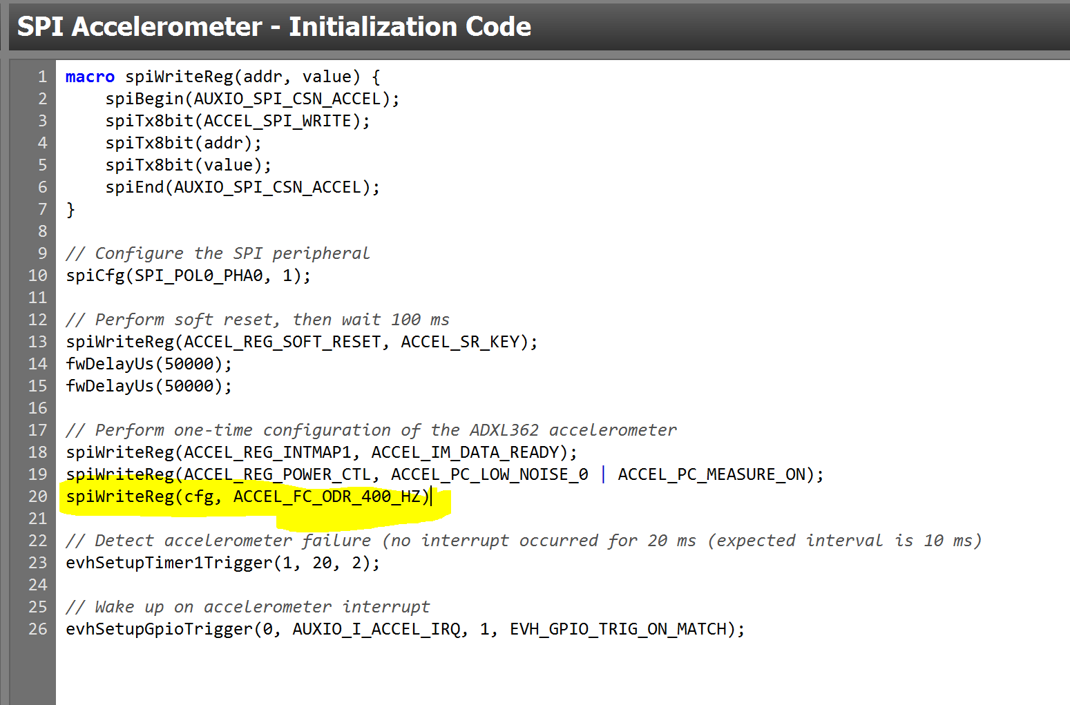

  • Thank you, all vey helpful, this gives me a lot to think about and experiment with. I have the SPI Accelerometer for LPSTK example code open in Sensor Controller Studio, how do I modify this to get 400Hz rather than 100Hz?
  • This is what I have added, is this correct?
  • Hello Richard,
    That is almost correct, but that won't work.
    Replace the cfg with ACCEL_REG_FILTER_CTL
    It should look like spiWriteReg(ACCEL_REG_FILTER_CTL , ACCEL_FC_ODR_400_HZ);
    AB

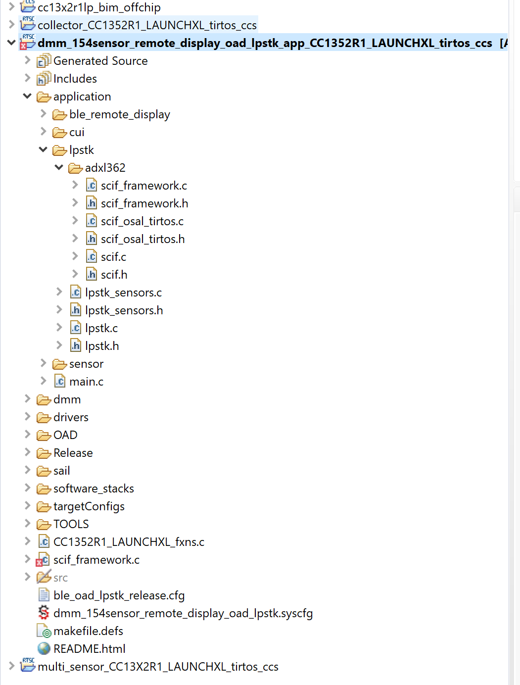

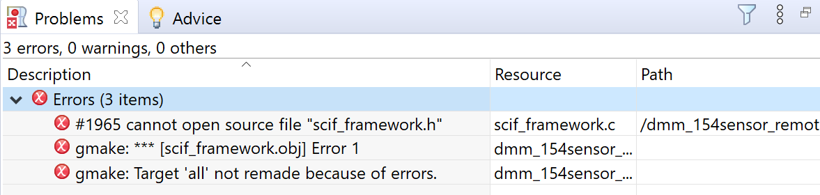

  • Ok, I have tried but am given the following errors when I build the dmm_154remote_sensor_lpstk_app in CCS:

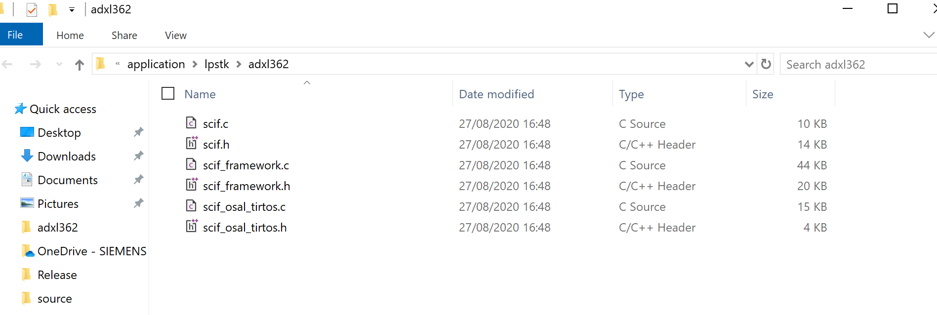

  • did you copy all the required files into the adxl362 folder?
    send a screenshot of the file structure.
    Try rebuilding and see if that helps.
  • Yes I copied all 6 files required. And I have tried rebuild and this is no better.
  • The problem seems to be that you copied one of those file to the root of the project.
    Delete it and it should build and compile.
