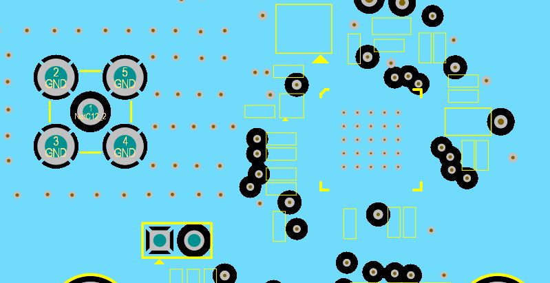

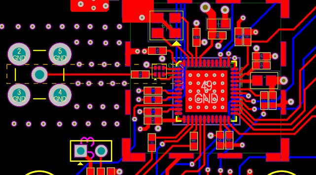

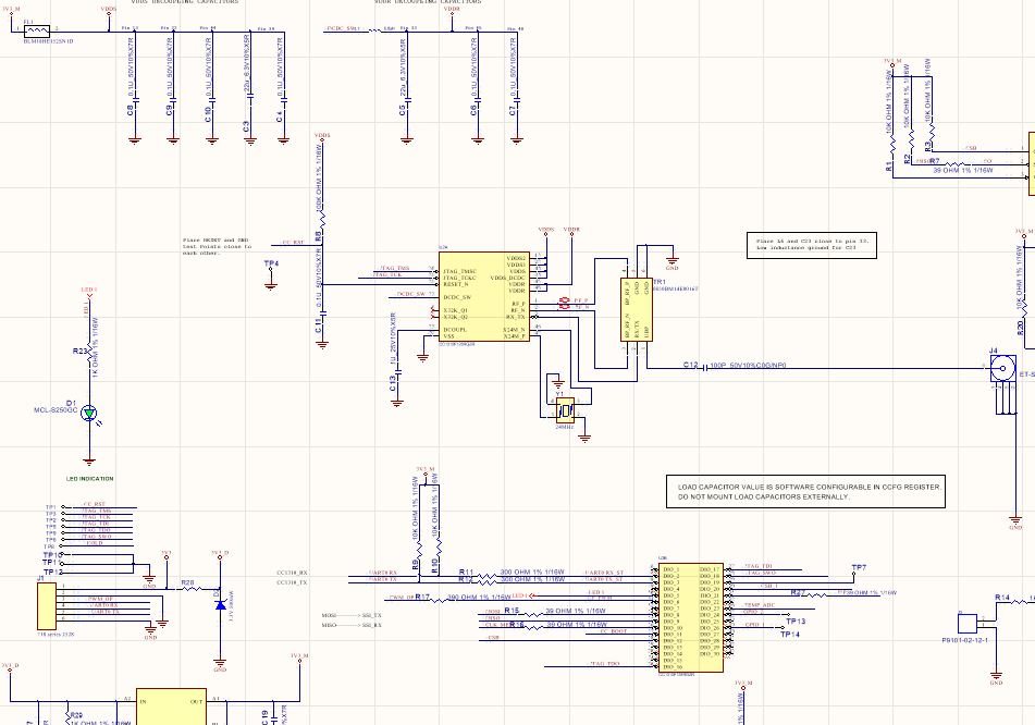

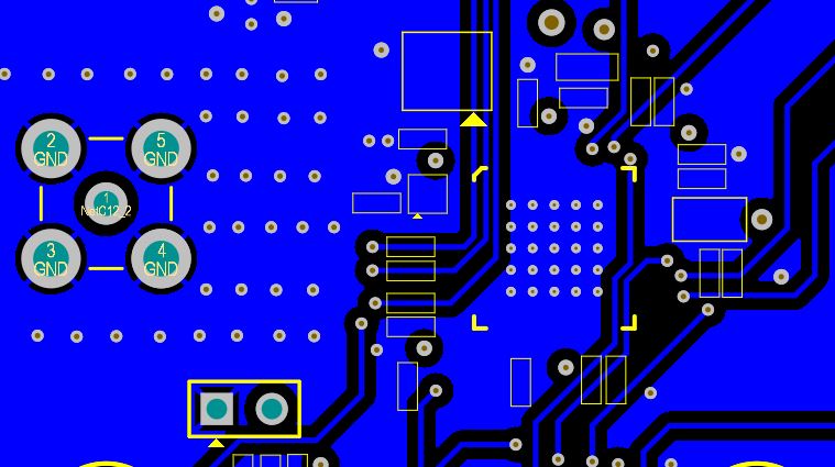

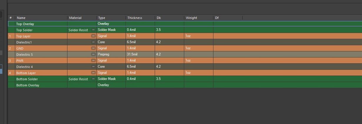

We designed and developed a project using CC1310. In this project, we built custom boards as per the CC1310 with help from Application Report SWRA524A. The boards are 4-layer impedance controlled boards. Pictures of schematics, layout, board stackup and component list are attached.

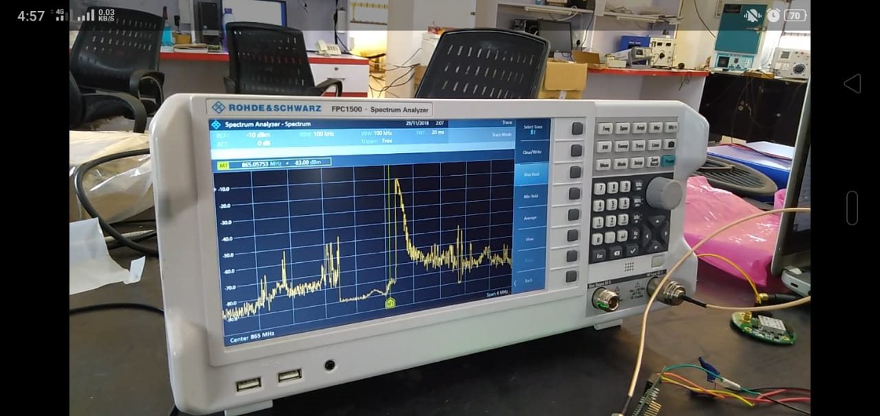

    The conducted power level we are measuring is -7.6 dbm (CC1310 is configured for 13 dbm output power).  Lot of spurious emissions are also seen outside the channel band. Please see attached picture1 of result on the spectrum analyser. Sometimes the channel envelope is not symmetrical (see picture2).

  • HI,
    Losing around 20 dB here...
    Make sure the IPC is in the right direction or not damaged.
    Do you see this on several boards / IPCs ?
       Richard

    The schematic looks OK but the layout does not look optimum.
    The top layer is *.GTL. Is *.G1 directly underneath the top layer. Then *.G2 and finally *.GBL at the bottom.
    *.G1 looks like a "solid" GND layer but do not understand why the power plane *.G2 has been opened up underneath the RF.
    Confirm which layer is underneath the top layer.
       Richard

    The layer order is GTL (top) followed by G1 (Ground) followed by G2 (Power) followed by GBL (Bottom).
    Power islands for VDDR, VDDS etc are implemented in G2 plane. Does G2 plane need to be changed?

    Our PCB stackup is different than the evaluation module layout. But we had designed as per 50 ohms impedance controlled PCB. Will this cause a problem?
