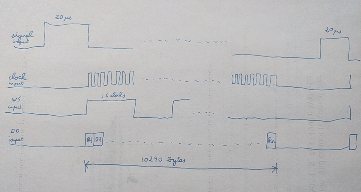

Short version: Is it possible to use the I2S driver with a single buffer?
Longer version: I have the following traffic:
I have the following reserved memory:
unsigned char mybuffer[10240];
I have a callback on the posedge of the SIGNAL interrupt and in this callback there are two options:
- either I want to "record" and store the coming 10240 bytes in mybuffer.
- or I don't want to do anything and mybuffer should not be touched.
I would like to avoid any memcpy, to have the minimum of interrupts/callbacks possible and to set fixedBufferLength to 10240.
Question 1: Is it better to stop/start the I2S (with the API I2S_stopClocks(handle); I2S_startClocks(i2sHandle); I2S_startRead(i2sHandle);) or is it better to have it running all the time? (Note that the I2S driver in SLAVE mode).
Question 2: Can I have one single buffer and how to manage it in readCallbackFxn?
Note that I "own" the clock, WS and D0 lanes from a FPGA (for instance, I could have a free-running clock).

    - an architecture challenge. When I'm about to receive some I2S traffic, my software decides if data should be stored in memory or if it should be ignored. Because I have only one memory buffer which is very large (>10kB), I cannot afford to have two buffers and receive the traffic in the second buffer to virtually discard it (i.e. not overwriting the first buffer). The solution is probably to use stop/startReads but I was not able to make this work reliably. In any case, I'm currently stopped by the first problem mentioned above.

    - because of the way the I2S module is made, you cannot start an I2S operation with only one buffer. You could chose to have two buffers twice smaller or modify the I2S driver (this could work only because you have a very big buffer).
    Looking at your draws one more time, I don't think you should call I2S_stopClocks() in between the transmissions (because you expect to sample on the very first WS cycle).

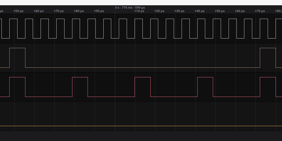

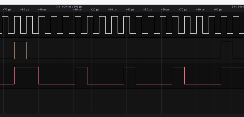

  • I really need a fix on this sub-problem #1 I describe above. I have spent more than a week full time on this integration thinking the problem was on my FPGA code, and the problem is on the TI driver side (even perhaps on hardware or in the datasheet).
    Your patch ONLY fixes the problem for output. It DOES NOT work for input in DSP / slave.
    - with the patch mentioned in the other thread, for a 16-bit transfer, you have 16 clock cycles between each WS including the WS. So the MSB happens at the same time than WS. It's not what the datasheet says. But it's fine. I'm interested only by input, output for me is just to understand how hardware is working.
    - with the code I sent you, for a 16-bit transfer, you have 17 clock cycles: the WS and then the 16-bit transfer. MSB happens after WS. This is what the datasheet says.
    - with your patch for input in DSP / slave, IT'S NOT WORKING. And both if my FPGA outputs 16 or 17 clocks.
    To help move forward, can you please provide a working example of input DSP/slave by connecting two launchpads, one in DSP/master (with your patch or with my modification), the other in DSP/input.

  • With my modification for output, the MSB bit is duplicated during the WS cycle.
    For input, it doesn't work.
  • In input mode, with your patch, 0x88 traffic is not recognized at all because hardware sees that one bit is missing so the transaction is never completed. It also proves that hardware wants 17 cycles for 16 bit in DSP (WS+data). With my modification, the traffic appears as 0x44 which makes me believe there is a bug in hardware (I hope I'm wrong - usually I'm wrong when I'm blaming hardware!).
